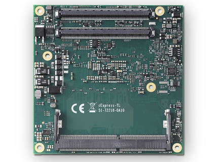

Intel has launched three embedded 11th gen, 10nm SuperFin fabricated Tiger Lake ULP3 “E” processors, keeping in mind the growing need for embedded applications. These new processors join with the earlier released nine Tiger Lake U-series ULP3 and lower-power Y-series ULP4 chips. Taking benefit from these new chips Adlink has now released a COM Express Compact Type 6 module which is called the cExpress-TL. It supports all three of the new “E” models plus a fourth, yet to be announced Celeron 6305E.
Adlink cExpress-TL
