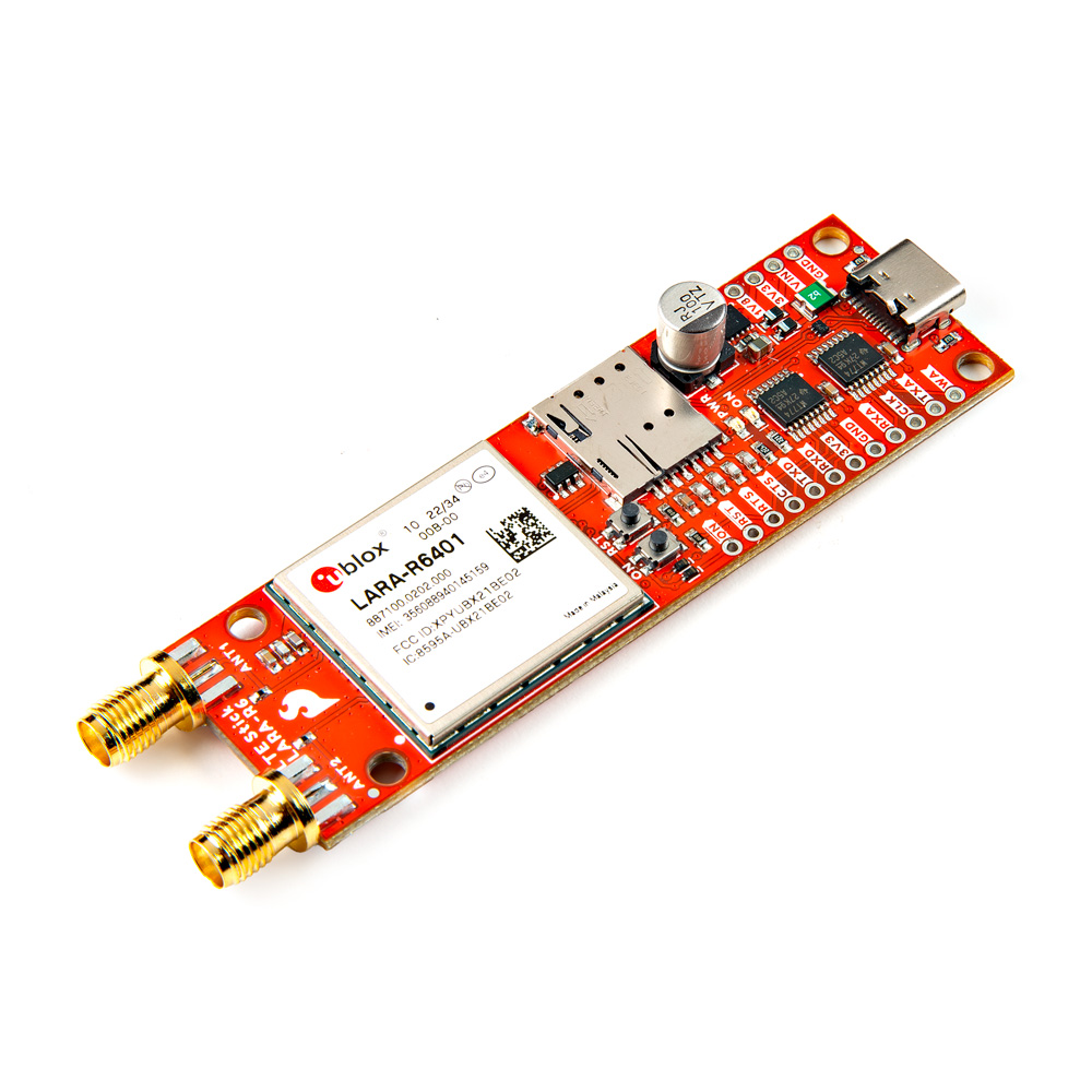

The SparkFun LTE Stick is A Development Platform for the u-blox LARA-R6 LTE Module
SparkFun has introduced the SparkFun LTE Stick - LARA-R6, a compact LTE development board with u-blox LARA-R6 LTE Cat 1 module. Designed for North America, it supports data and voice with major networks like AT&T, Verizon, T-Mobile, and FirstNet, and includes a nanoSIM card slot for network selection.
SparkFun LARA-R6 LTE Stick is a newly introduced compact development board, featuring u-blox's LTE Cat 1 module, designed for North America. It supports data and voice with major networks and includes a nanoSIM card slot
SparkFun has introduced the SparkFun LTE Stick – LARA-R6, a compact LTE development board with u-blox LARA-R6 LTE Cat 1 module. Designed for North America, it supports data and voice with major networks like AT&T, Verizon, T-Mobile, and FirstNet, and includes a nanoSIM card slot for network selection.
The LARA-R6 supports various LTE bands and offers key features like over-the-air firmware updates, security enhancements, jamming detection, and antenna/SIM detection, among others.
The LTE Stick is designed for easy prototyping on a breadboard and supports both data and voice, enabling the creation of DIY telephones. It features two antenna connectors for data transmission and reception. The board can be powered via a USB-C connector or an alternative power input and includes additional points for advanced customization.
SparkFun LARA-R6 LTE Stick Specification:
  • Module: LARA-R6401 LTE Cellular Module, tailored for North America
  • LTE Support: Compatible with FDD Bands 2, 4, 5, 12, 13, 14, 66, and 71
  • Interfaces:
    • Dual UART
    • USB 2.0
    • I2C
    • 9 GPIO pins
    • Digital Audio (I2S)
  • Connectivity: Nano SIM Card Slot for network access
  • User Controls: Power On and Reset Buttons for easy management
  • Power Supply:
    • USB-C Connector for primary power input
    • PTH Connections for Power (VIN, 3.3V, and 1.8V)
  • Expansion and Prototyping:
    • PTH Connections for UART, I2S, Reset, and Power On signals
    • Test Point Cluster for advanced connections (1.8V only) including GPIO (1, 2, 3 & 6), UART2, and I2C
  • Antenna Connections: Two SMA Antenna Connectors
    • Primary Antenna for both Transmit and Receive
    • A secondary Antenna dedicated to Receive Only
The company offers essential resources for the product, including schematics, hardware design files, setup guides, a DIY telephone blog post, technical manuals for the LARA-R6 module, software tools like the m-center and its guide, and an Arduino library, all available on their GitHub Hardware Repository.
The CEL-23618 is an open-source hardware product, and at the time of writing this article, it is in stock and can be purchased from SparkFun for $149.95.
