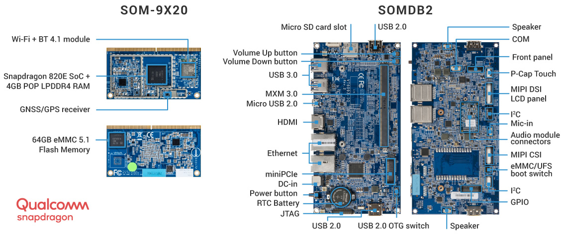

The VIA SOM 9×20 module is one of those modules you can’t afford to pass you by. At the heart of the module is the powerful Qualcomm Snapdragon 820E embedded platform, the high performance embedded platform designed to power the next generation of mobile devices and applications with low power consumption, and an array of possible connectivity.
The SOM 9×20 module measures at about 82 x 45mm in a SODIMM styled form factor. It features four Cortex-A72-like cores Kryo cores: two at 2.2GHz and two at 1.6GHz. The SoC is boosted with an integrated Adreno 530 GPU at 624MHz, Hexagon 680 DSP, and 14-bit Spectra ISP. The module ships with an inbuilt 64GB eMMC Flash memory, 4GB LPDDR4 in a POP package, rich I/O and display expansion options through its MXM 3.0 314-pin connector.
It supports USB 3.0, USB 2.0, HDMI 2.0, SDIO, PCIe, MIPI CSI, MIPI DSI, and multi-function pins for UART, I2C, SPI, and GPIO through the MXM connector. Other possibilities include interfaces for  MIPI-CSI and LCD touchscreen, dual speakers, and a mini-PCIe slot.
