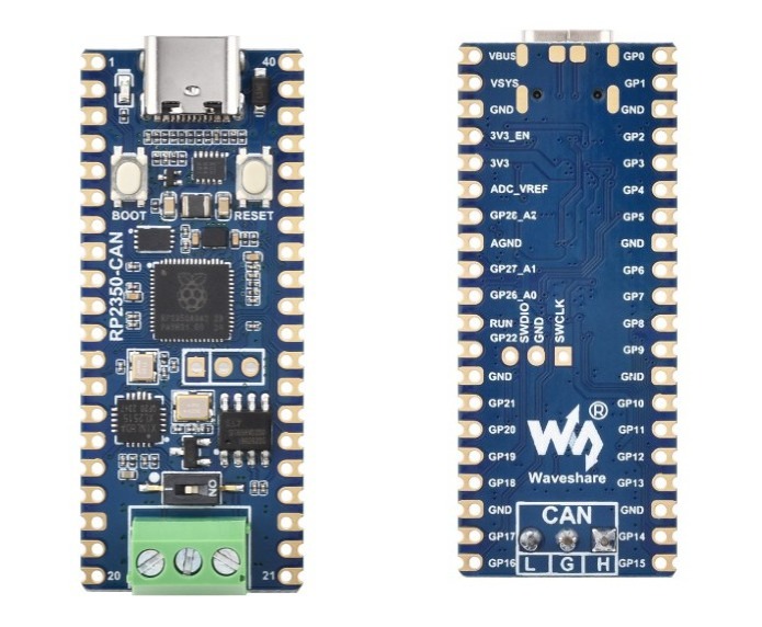

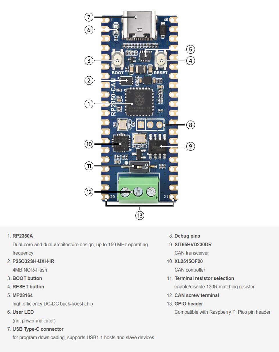

Waveshare has recently launched the RP2350-CAN development board, a Pico-like MCU board based on Raspberry Pi RP2350A SoC with onboard XL2515 CAN Bus controller and a SIT65HVD230DR CAN transceiver. The board supports the CAN V2.0B protocol specification with a communication rate up to 1 Mbps, and the XL2515 chip appears to be a clone of the popular Microchip MCP2515 CAN controller.
Based on the Raspberry Pi RP2350A microcontroller, featuring a unique dual-core, dual-architecture design with an Arm Cortex-M33 processor and a Hazard3 RISC-V processor, running at up to 150MHz, the RP2350-CAN development board includes the same 26 multi-function GPIO pins and USB-C port as found on the Raspberry Pi Pico 2. Other features include a DC-DC buck-boost converter (MP28164), Drag-and-drop programming using mass storage over USB Type-C 1.1, a selectable 120Ω CAN termination resistor, and CAN screw terminals. The CAN Bus board targets automotive, industrial control, and robotics applications.

  • SoC: Raspberry Pi RP2350A
    • Dual-core Arm Cortex-M33 @ 150MHz with TrustZone and Secure Boot
    • Dual-core RISC-V Hazard3 @ 150MHz
  • Memory: 520KB on-chip SRAM
  • Storage: 4MB NOR Flash (P25Q32SH-UXH-IR)
  • USB:
    • USB Type-C for power and programming
    • USB 1.1 host/device support
  • CAN bus:
    • Xinluda XL2515 CAN controller
    • SIT65HVD230 CAN transceiver
    • Supports CAN 2.0B up to 1 Mbps
    • 120Ω terminal resistor switch
    • CAN screw terminal
  • Expansion:
    • 2x 20-pin headers

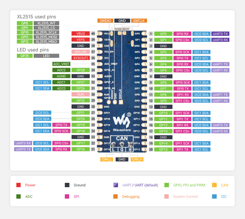

    • 26x multi-function GPIOs
    • 2x UART, 2x SPI, 2x I2C
    • 16x PWM channels
    • 4x ADCs
    • 3x PIO blocks, 12x PIO state machines
  • Debug: SWD debug interface header
  • Miscellaneous:
    • Boot and reset buttons
    • User LED
    • On-chip temperature sensor
    • On-chip accurate clock and timers
    • Drag-and-drop programming via USB mass storage
    • Low-power sleep and dormant modes
  • Power supply: 1.8V to 5.5V input with MP28164 DC-DC converter
  • Dimentions: 51 x 21mm (Raspberry Pi Pico / Pico 2 compatible)
  • Package: QFN-60
