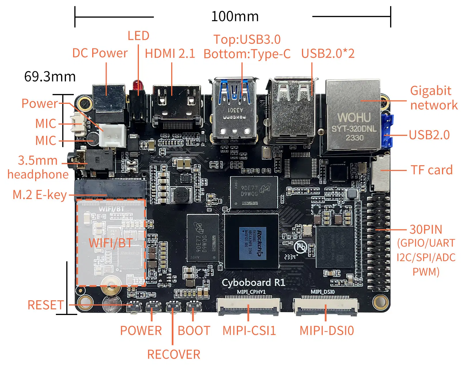

Youteetoo has just released the Youteetoo Cyboboard R1 or in short Youyeetoo R1, it is a Rockchip RK3588S-based SBC in a 100×69.3mm form factor. The board is tiny but packs a boatload of features including two M.2 ports, WiFi and Bluetooth connector, NFC, four display interfaces, dual MIPI CSI interfaces, and many other features.

Additionally, the board includes up to 32GB RAM, 256GB eMMC, gigabit Ethernet, five USB ports, a built-in microphone, various audio I/O, a 30-pin expansion header, and more.

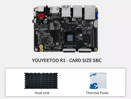

The SBC doesn’t have a heat sink, but the company later released a heatsink that can be found in the Aliexpress store with 3M thermals.
Youyeetoo R1 specifications:
  • SoC: Rockchip RK3588S
  • CPU: Octa-core with 4x Cortex-A76 cores @ up to 2.2-2.4 GHz, 4x Cortex-A55 cores @ up to 1.8 GHz
  • GPU: Arm Mali-G610
  • VPU: 8Kp60 video decoder, 8Kp30 video encoder
  • AI Accelerator: 6 TOPS NPU
  • Memory: 4GB, 8GB, 16GB, or 32GB LPDDR4x
  • Storage: 32GB, 64GB, 128GB, or 256GB eMMC, M.2 NVMe/SATA SSD, MicroSD
  • Video Output: HDMI 2.1 up to 8Kp60, MIPI DSI, USB Type-C with DP1.4
  • Video Input: 2x MIPI CSI, optional HDMI input
  • Audio: 3.5mm jack, HDMI, on-board microphone
  • Networking: Gigabit Ethernet, M.2 WiFi 5/6 & Bluetooth 5.0/5.2, NFC
  • USB: 1x USB 3.0, 2x USB 2.0, 1x USB 3.1 OTG Type-C
  • Expansion: M.2 sockets for SSD/LTE, GPIO header, Debug UART
  • Misc: Power/Recovery/Reset/Boot buttons, user LEDs, RTC battery connector, fan connector
  • Power Supply: 12V/3A via DC jack or 2-pin socket
  • Dimensions: 100 x 69.3 mm
