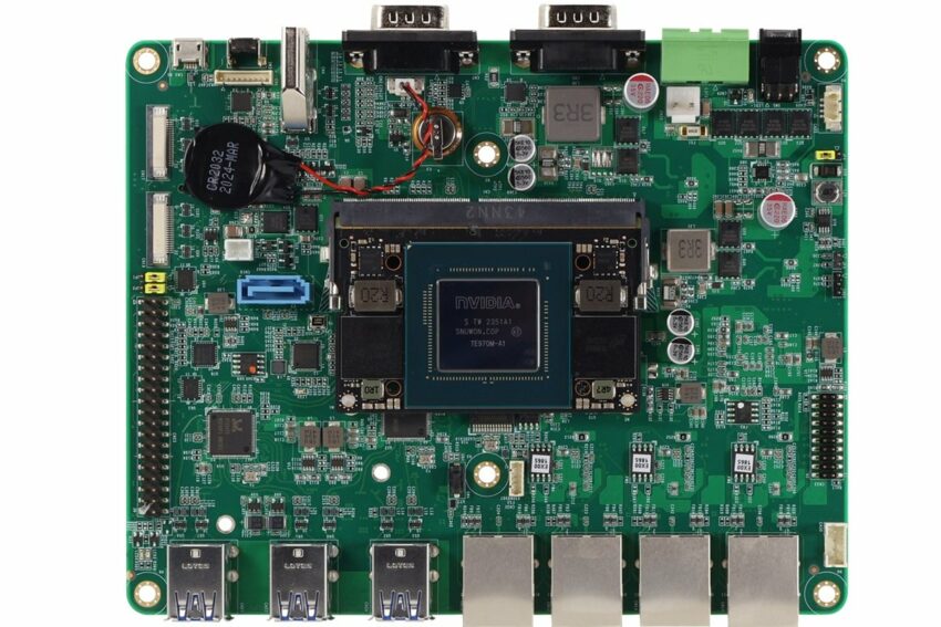

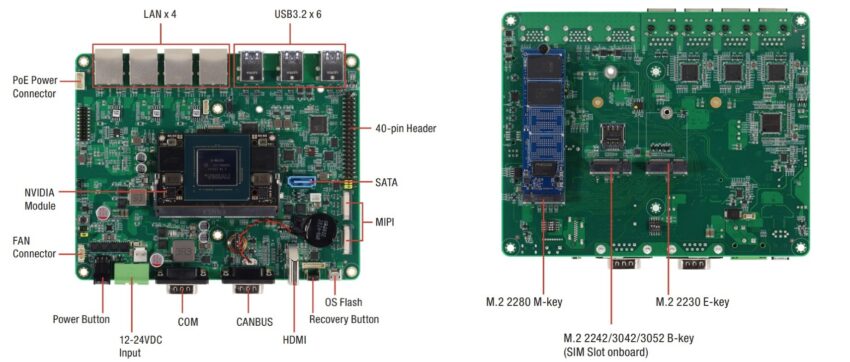

AAEON has launched the BOXER-8654AI-KIT, a development kit powered by the NVIDIA Jetson Orin NX module, available in 8GB and 16GB variants. The carrier board provides extensive I/O features, including six USB 3.2 Gen 2 ports, four LAN ports with optional PoE, an Out-of-Band (OOB) management header, and dual DB-9 ports supporting RS-232/422/485 and CANBus. Display options include an HDMI Type-A port and two MIPI CSI connectors, each supporting dual MIPI cameras. Additional interfaces include a 40-pin NVIDIA Jetson-compatible header offering I2C, SPI, UART, and more.
The kit supports M.2 E and B-key slots for Wi-Fi and 5G modules, with an onboard SIM for cellular connectivity, as well as storage options via an M.2 M-Key slot for NVMe SSDs and a SATA slot. Preloaded with NVIDIA Jetpack 6.0 SDK, the kit includes tools like CUDA, cuDNN, TensorRT, Vulkan, and OpenCV, enabling efficient development of AI, multimedia, and graphics applications. The BOXER-8654AI-KIT provides a complete platform for building high-performance edge AI solutions.

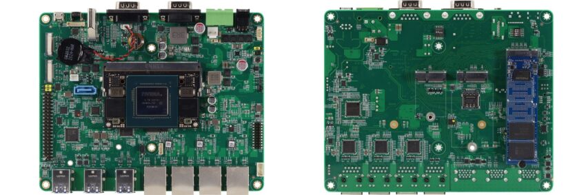

BOXER-8654AI-KIT front and back
AAEON BOXER-8654AI-KIT specifications:
  • AI Accelerator: NVIDIA Jetson Orin NX
    • CPU Options:
      • Orin NX 16GB: 8-core Arm Cortex-A78AE, ARMv8.2 64-bit
      • Orin NX 8GB: 6-core Arm Cortex-A78AE, ARMv8.2 64-bit
    • System Memory:
      • 16GB LPDDR5 (16GB variant)
      • 8GB LPDDR5 (8GB variant)
    • Storage Device: M.2 M-Key 2280 (NVMe)
  • Connectivity:
    • Ethernet: 4x GbE LAN (RJ-45, optional PoE at 25.6W per port)
    • USB Ports:
      • 6x USB 3.2 Gen 2 (Type-A)
      • 1x Micro USB for image flashing
    • Serial Communication:
      • 1x DB-9 for RS-232(RX/TX/GND)/422/485
      • 1x DB-9 for CANBus
      • 1x 40-pin Header (NVIDIA Jetson Orin Nano Developer Kit compliant)
      • 1x Pin Header for RS-232/422/485 via UART to 40-pin
      • 1x Box Header for Out-of-Band (OOB) management
  • Display and Expansion:
    • Display Interface: 1x HDMI Type-A (HDMI 1.4)
    • Camera Interface: 2x MIPI CSI connectors (4 lanes per connector, IMX219 default)
    • Expansion Slots:
      • 1x M.2 E-Key (2230)
      • 1x M.2 B-Key (2242/3042/3052) with onboard SIM
      • 1x M.2 M-Key (2280)
  • Power and Mechanical:
    • Power Input: 12V ~ 24V DC via 2-pin Terminal Block
    • Dimensions: 166mm x 133mm
    • Weight:
      • Net: 0.42 lbs (0.19 kg)
      • Gross: 0.79 lbs (0.36 kg)
  • Environmental Specifications:
    • Operating Temperature: -25°C to 70°C (-13°F to 158°F) with fan kit, 0.5 m/s airflow
    • Storage Temperature: -40°C to 85°C (-40°F to 185°F)
    • Storage Humidity: 5% to 95% @ 40°C (non-condensing)
  • Certifications: CE / FCC Class A
BOXER-8654AI-KIT powered by NVIDIA Jetson Orin NX module specifications
