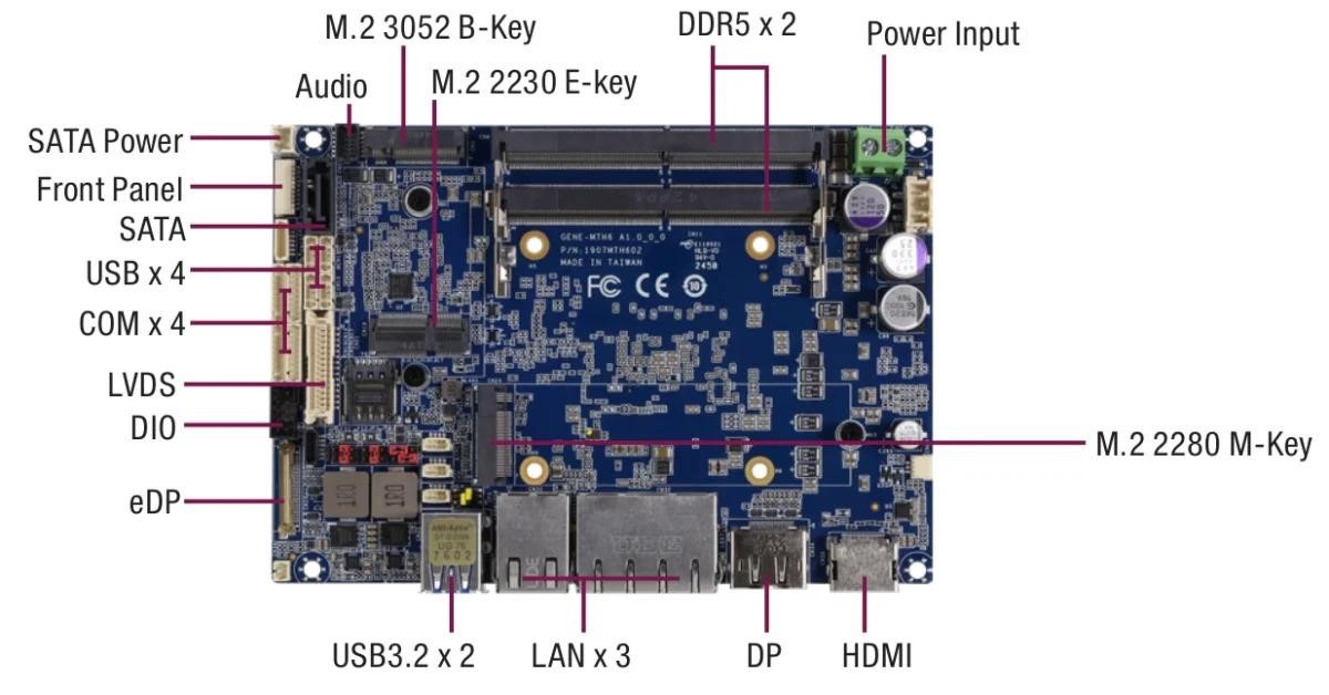

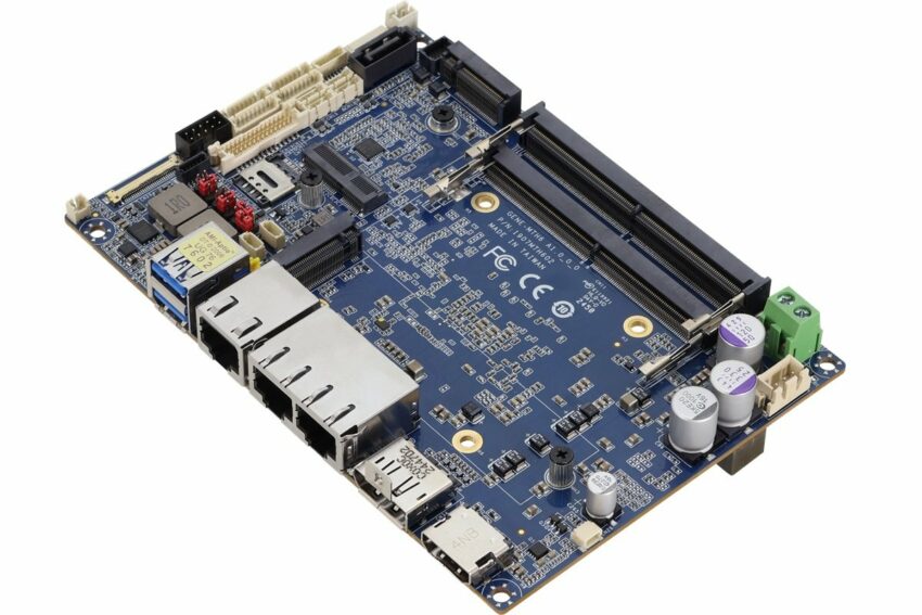

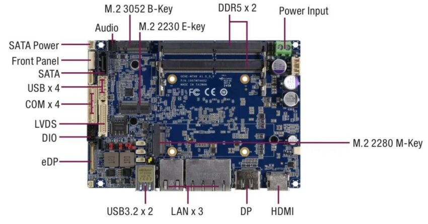

The demand for high-performance and compact single-board computers (SBCs) has been increasing rapidly in various industries. AAEON has announced its GENE-MTH6, the latest addition to its 3.5″ subcompact board product line. Equipped with Intel Core Ultra processors and up to 96 GB DDR5 via SODIMM, which utilizes the platform’s Intel Arc Graphics and integrated NPU to execute complex AI and machine learning workloads on the edge.
Highlights
  • Intel® Core™ Ultra processors (Series 1)
  • DDR5 5600 MHz, Dual Channel SODIMM x 2, up to 96GB
  • LVDS x 1, eDP x 1, DP x 1, HDMI x 1
  • LAN x 3, SATA 6Gb/s x 1, 8-bit GPIO
  • USB 3.2 Gen 2 x 2, USB 2.0 x 4
  • M.2 2280 M-Key x 1, M.2 3052 B-Key x 1, M.2 2230 E-Key x 1
  • DC Input 9 ~ 36V

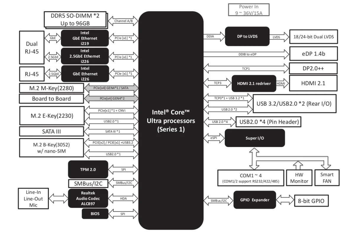

GENE-MTH6 Block diagram
Architecture and Applications
GENE-MTH6 featured Image
AAEON’s GENE-MTH6 offers either 15W U-Series (Intel Core Ultra 5 125U / Core Ultra 7 155U) or 28W H-series (Intel Core Ultra 5 125H / Core Ultra 7 155H) processors. The board also features two 2.5GbE and one GbE port, supports WiFi 6 and 5G via M.2 sockets, a SATA port and an M.2 socket for storage expansion with RAID support, four display interfaces, USB ports, four internal COM ports for RS232 and/or RS485.
Lastly, the GENE-MTH6 supports various operating systems, including Windows 10 64-bit, Windows 11 64-bit, and Ubuntu 22.04.3, and features an ERP-compliant 9V to 36V power input range. The board’s high-performance processing, wide power input range, and multiple display interfaces make it a good choice for industrial automation applications. Also, the GENE-MTH6’s higher performance processing and multiple display interfaces make it a fit for healthcare applications, such as medical imaging and patient monitoring.
