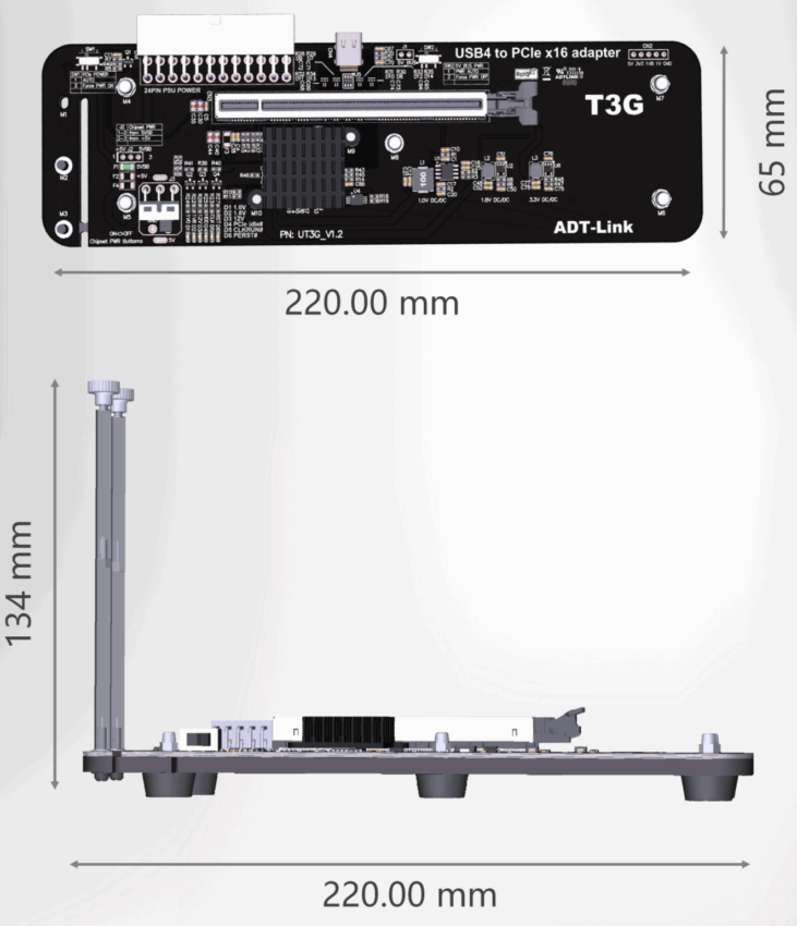

The module is built around an ASM2464PD USB4 /Thunderbolt to PCIe accessory controller and the board features a USB-C port for data a 24-pin ATX connector for power and some additional switches to set some configuration parameters like force boot, bus select, etc..

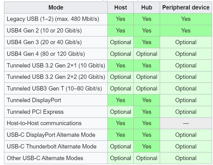

Now take a look at the USB4 standard its flexible, and allows for various features like 40 Gbit/s transfer speeds, tunneling of different protocols (USB 3.2, USB4, and PCIe), and varying levels of performance. However, not all features are mandatory for a device to be USB4 compliant. This means that some USB4 devices might not offer the full range of capabilities, but can still be labeled as USB4.
Although USB4 is derived from the Thunderbolt 3 specification and is theoretically compatible with Thunderbolt 3 devices (similar to Thunderbolt 4), the actual capabilities of a USB4 port can vary due to different implementations. Therefore, simply labeling a port as USB4 doesn’t guarantee full compliance with the USB4 standard or complete compatibility with all Thunderbolt 3 devices.
ADT-Link UT3G USB to PCIe Adapter Specifications
  • Chip: ASMedia ASM2464PD USB4/Thunderbolt to PCIe Accessory controller
  • Type-C interface specifications: Compatible with USB4, Thunderbolt 3, Thunderbolt 4
  • Bandwidth: 40Gbps
  • PCIe interface: Card slot – PCIe x16; Speed bandwidth – PCIe 4.0 x4
  • Supported GPU: NVIDIA series, AMD series
  • Power Supply: 75W via 24-pin ATX connector
  • Working Temperature: -20°C to 80°C
  • Dimensions: 220x65mm

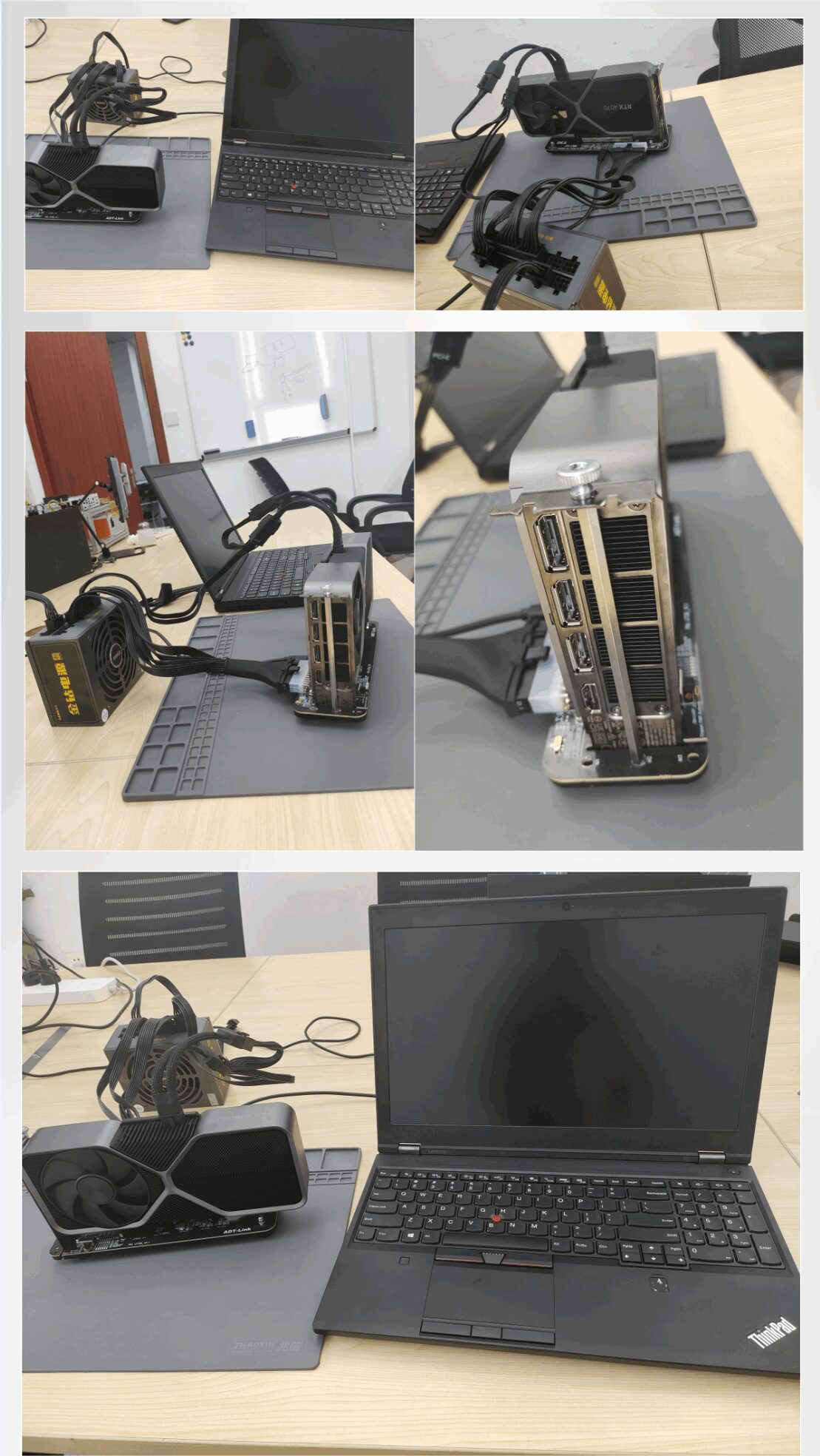

To learn more about the UT3G USB to PCIe adapter, you can visit the DFrobot wiki or the ADT-Link website. ADT-Link also demonstrates how this adapter works with regular laptops and shares benchmarks and other information using an AMD Radeon RC 5900XT GPUs.
