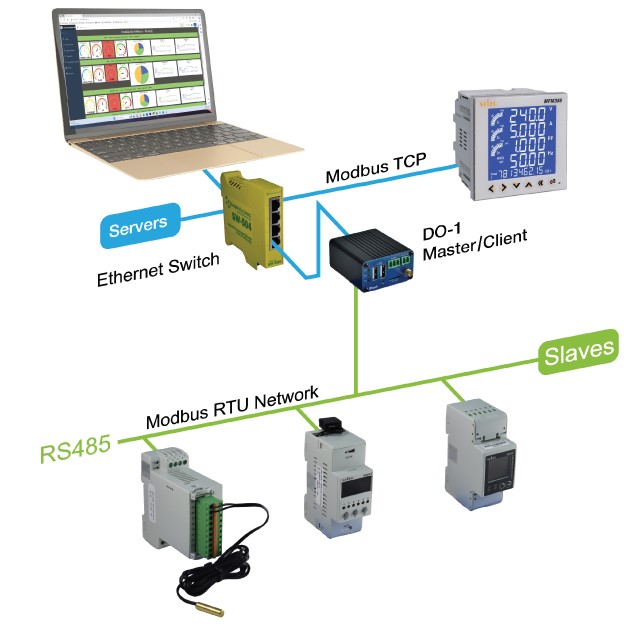

Altech’s universal DO-1 monitor for Modbus devices tracks temperature, humidity, pressure, vibration, energy usage, among other parameters, alerting to equipment statuses. It connects to up to 128 Modbus RTU/TCP devices and supports integration with new and legacy Modbus networks, leveraging the protocol’s industry adoption for cost-effective data monitoring. The DO-1 features 5GB of internal data storage expandable up to 128GB with a microSD card, dual Ethernet, and optional Wi-Fi and Bluetooth connectivity.

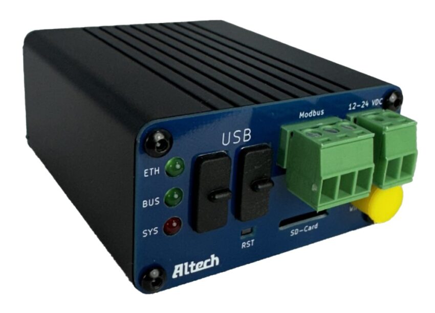

Altech DO-1 Modbus front

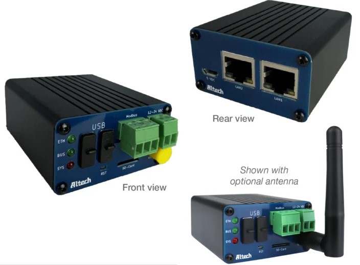

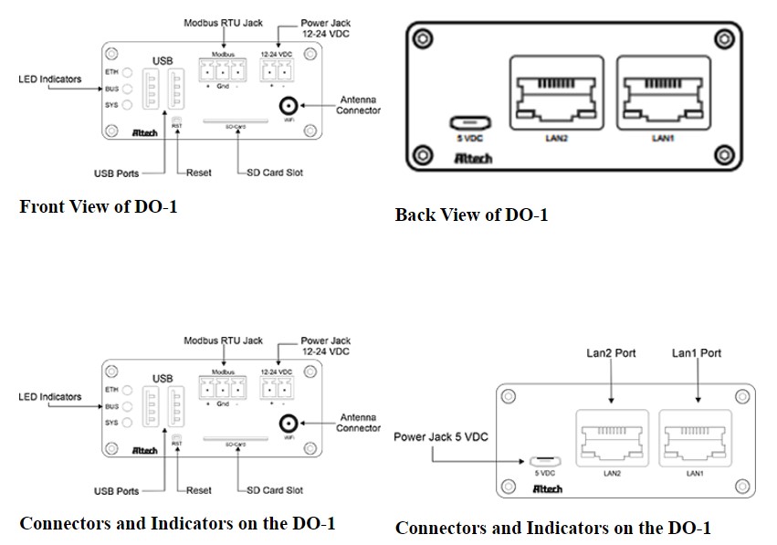

Altech DO-1 Universal Monitor Specifications:
  • Storage:
    • 5GB internal data storage
    • MicroSD card slot, supports up to 128GB
  • Networking:
    • 10/100Mbps Fast Ethernet RJ45 (LAN1)
    • 10/100/1000Mbps Ethernet RJ45 (LAN2)
    • Configurable LAN1 and LAN2 in switch or 2-port mode
    • Optional Wi-Fi 802.11 b/g/n and Bluetooth (external antenna)
  • USB: 2x USB 2.0 Type-A ports (up to 1.5A)
  • Serial: 3-pole MODBUS Master (RS-485) with 3.5mm terminal block
  • Misc:
    • Reset button
    • ETH, BUS, and SYS status LEDs
    • Real-time clock (RTC) with 30-day battery backup
  • Power:
    • 12V to 24V DC input via 2-pole 3.5mm terminal block (polarity protection)
    • 5V DC backup via micro USB port
    • Power consumption: Typical 3W, Max 12W
  • Dimensions: 75 x 55 x 30 mm
  • Weight: 130 grams
  • IP rating: IP20
  • Environmental:
    • Operating temperature: -20°C to +50°C
    • Storage temperature: -40°C to +85°C
    • Humidity: 90% non-condensing
Altech offers two models such as: freestanding (DO-1) and DIN rail mount (DO-1-DR). By default, the DO-1 ships with a USB 2.0 Type-A / USB 2.0 Micro-B Cable, an antenna dust cap, a two USB Type-A dust caps, and 2-pole and 3-pole connectors with screw terminals.
Altech promotes the DO-1 as a user-friendly, do-it-yourself solution that requires no programming knowledge. Its intuitive web interface makes configuration simple, allowing users to create custom dashboards to visualize data and set up personalized alerts or events with email notifications. The DO-1 offers powerful data collection features, enabling users to easily filter and export data to Excel or CSV files for detailed analysis and reporting.
The DO-1 is ideal for various applications, including energy monitoring in commercial buildings, machine condition monitoring, server room and data center supervision, as well as liquid level monitoring in tanks and reservoirs, among others.
