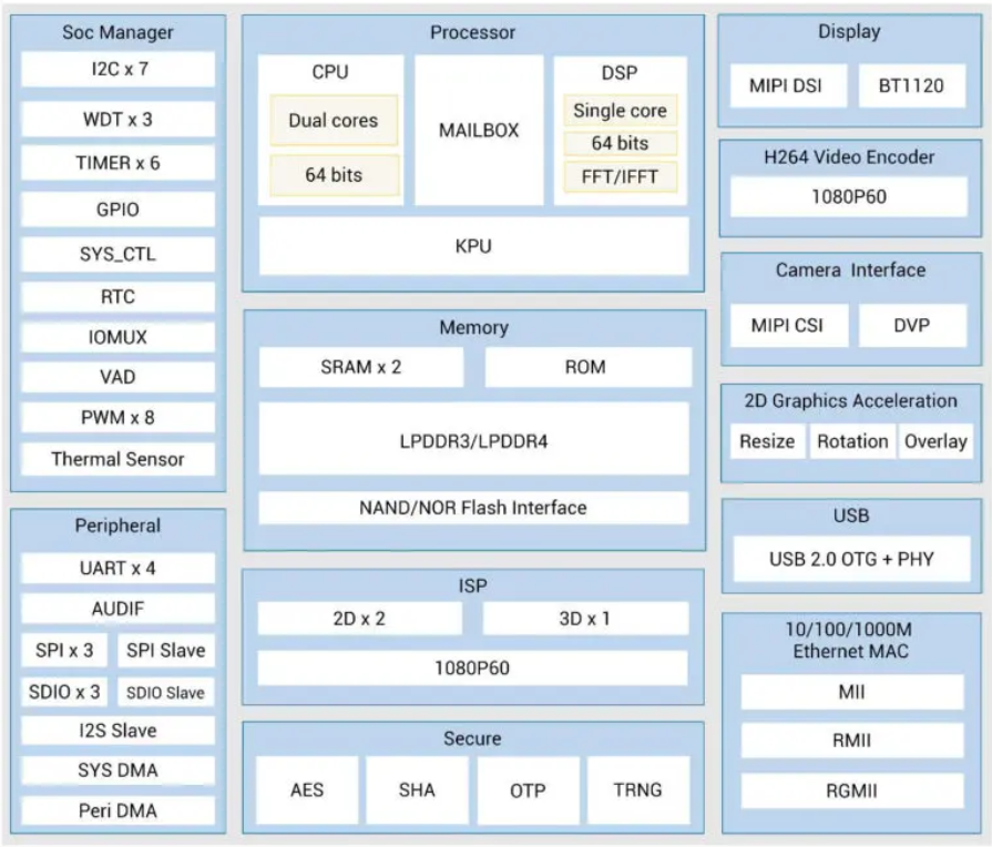

Block Diagram of Kendryte K510 Processor
The compact Kendryte K510 AI processor features a 64-bit tri-core RISC-V processor with FPUs. It is divided into a dual-core block that operates at 800MHz and a single-core block that serves as a digital signal processor (DSP).
The main highlight of K510 is that it can triple its computing power while reducing power consumption by adopting unique computing data flow and multiplexing technology. Thus, the chip can perform 3 TOPs (Tera Operations Per Second) for applications requiring faster time responses.
The new K510 also features USB 2.0 OTG compatibility, MIPI CSI, and DVP camera interfaces, gigabit Ethernet, an H.264 video processing unit that is capable of 1080p60 along with MIPI DSI, and BT1120 display choices. It also offers various peripherals, including four UARTs, AUDIF, three SPI buses, three SDIO buses, etc. Additionally, the SHA and AES accelerator provide on-chip security.
All these pairs with K510’s on-chip 1.5MB SRAM split into 1MB and 512kB blocks with LPDDR3/LPDDR4 support for system RAM. The chip integrates a next-generation image processor with 2D/3D noise reduction, WDR (Wide Dynamic Range), fisheye correction, and hardware 3A capabilities.
The K510 is highly configurable, thanks to its RISC-V open-source architecture, and capable of empowering developers when it comes to scenario-based programming. For more information visit the company’s official website.
