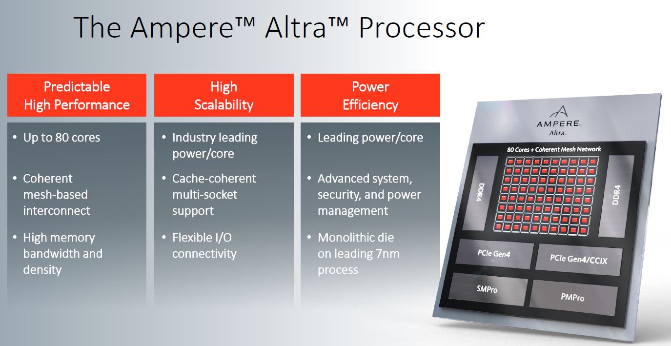

Altra is an 80-core processor based on Neoverse N1 license, designed for predictable high performance, security isolation, scalability and leading power efficiency. It comes in single socket and dual socket versions, which are sampling to customers.
The device is scalable up to 80 cores per chip with a power consumption footprint of up to 210W. The cores are specificed up to 3.0GHz clock frequency. The core is a four-instruction wide superscalar out-of-order processor based on the ARMv8.2 instruction set architecture. Each core is single-threaded to provide reduced performance variability and increased security against system-level side-channel attacks.
There are 64kbyte level-one instruction and data caches per core and 1Mbyte level 2 data caches per core. There is also a processor-wide 32Mbyte system-level cache.
There are 8 72bit-wide DDR4 interfaces per chip and 128 lanes of PCIe Gen4 for highest IO bandwidth.
