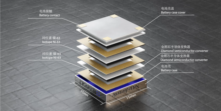

Beijing Betavolt New Energy Technology Co.Ltd., also known as Betavolt, has announced the BV100, a 3V "nuclear battery" for everyday use. This 15 x 15 x 5mm battery has a max output capacity of 100 microwatts (µW) and can last for 50 years without the need for a recharge.
Beijing's Betavoter announced the BV100, Betavoter 3V Atomic Battery sized at 15 x 15 x 5mm, with a 100 µW output and a 50-year lifespan.
Beijing Betavolt New Energy Technology Co.Ltd., also known as Betavolt, has announced the BV100, a 3V “nuclear battery” for everyday use. This 15 x 15 x 5mm battery has a max output capacity of 100 microwatts (µW) and can last for 50 years without the need for a recharge.
The company claims that this 3V atomic battery “can meet the needs of long-lasting power supply in multiple scenarios such as aerospace, AI equipment, medical equipment, MEMS systems, advanced sensors, small drones, and micro-robots. This new energy innovation will help China gain a leading edge in the new round of AI technological revolution.”
The battery was first brought to our attention by Tom’s Hardware, this battery is in its pilot stage ahead of mass production, The company says multiple BV100 batteries can be used together in series or parallel depending on device requirements, and Betavolt has plans to launch a 1-watt version of its atomic battery in 2025.
In a press release, the company said that The Betavolt BV100 is different from old atomic batteries, the old batteries were big, unsafe, and used dangerous materials like Plutonium. The BV100 is safer and won’t leak radiation, even if it’s damaged. the company also claims that Betavolt is the only company with the technology to create large diamond semiconductors, used in their BV100 battery, which uses their 4th generation diamond material.

  • Materials: Constructed using a nickel-63 isotope and diamond semiconductor material

  • Manufacturing Process: Involves placing a 2-micron-thick nickel-63 sheet between two diamond semiconductor converters using a single-crystal diamond semiconductor that is just 10 microns thick
