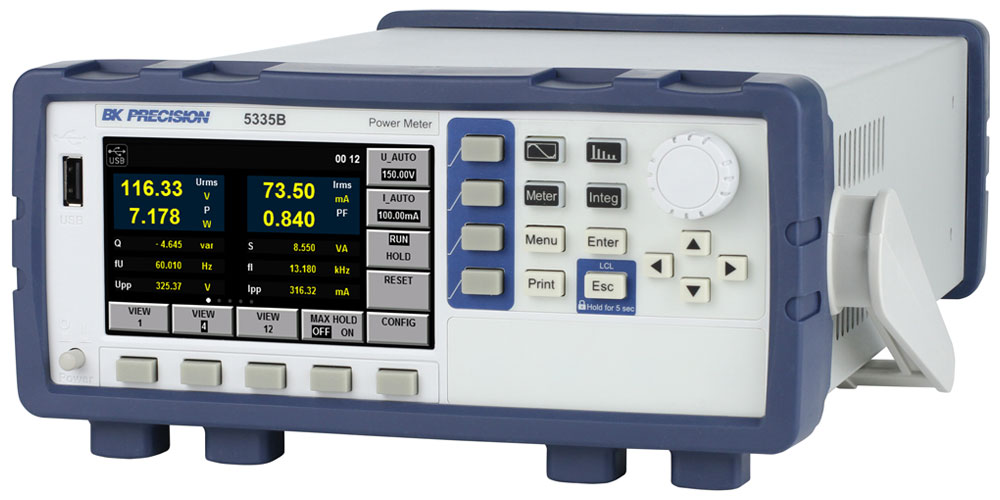

B&K Precision 5335C Single-Phase AC-DC Power Meters measure and analyze power consumption and power quality parameters quickly and accurately. The 5335C supports power measurements up to 600VRMS and 20ARMS with a bandwidth up to 100kHz.
B&K Precision 5335C Single-Phase AC-DC Power Meters measure and analyze power consumption and power quality parameters quickly and accurately. The 5335C supports power measurements up to 600VRMS and 20ARMS with a bandwidth up to 100kHz. Feature-rich measurement functions include all AC and DC parameters (power, current, voltage, power factor, frequency, and phase.) A powerful integration function performs harmonic measurements to the 50th order and an oscilloscope mode for viewing voltage and current reading in the time domain. Twelve real-time parameters can be measured and displayed simultaneously in user-customizable views.
  • 600VRMS (Cat II) and 20ARMS direct input ranges
  • DC frequency range from 0.5Hz to 100kHz
  • 0.1% basic accuracy for voltage and current measurements
  • 4.3″ color LCD (TFT)
  • Simultaneously measure and display up to 12 measurement parameters
  • Capture inrush current and voltage surge with the peak function
  • Integration function with automatic range switching
  • Harmonic measurements to the 50th order
  • Ability to measure electrical energy which is produced or consumed
  • Pre-compliance testing according to IEC/EN 62000-3-2 / 4-7
  • Standard USB (USBTMC compliant), RS232, and LAN interfaces
  • Line and frequency filter capability for reducing unwanted signal noise
  • Optional universal breakout box to simplify the connection between the power meter and DUT
