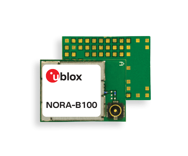

There are three Nora-B1 products, differing in their antenna set-up mainly:
  • NORA-B100 with U.FL connector for an external antenna
  • NORA-B101 with antenna pin for an external antenna
  • NORA-B106 with internal PCB antenna
