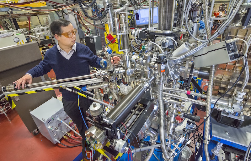

Bekley Lab's researcher is working with advanced light source
Berkley Lab’s researcher is working with advanced light source
With this discovery to stabilize lithium-sulfur batteries­ Liu now wants to improve the lifetime of lithium-sulfur batteries even further. The target of the researchers is to get thousands of cycles from lithium-sulfur chemistry. They are striving to find answers to questions like after this polymer binds with sulfur, what happens next? How does it react with sulfur, and is it reversible? Liu said,
