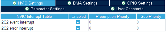

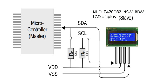

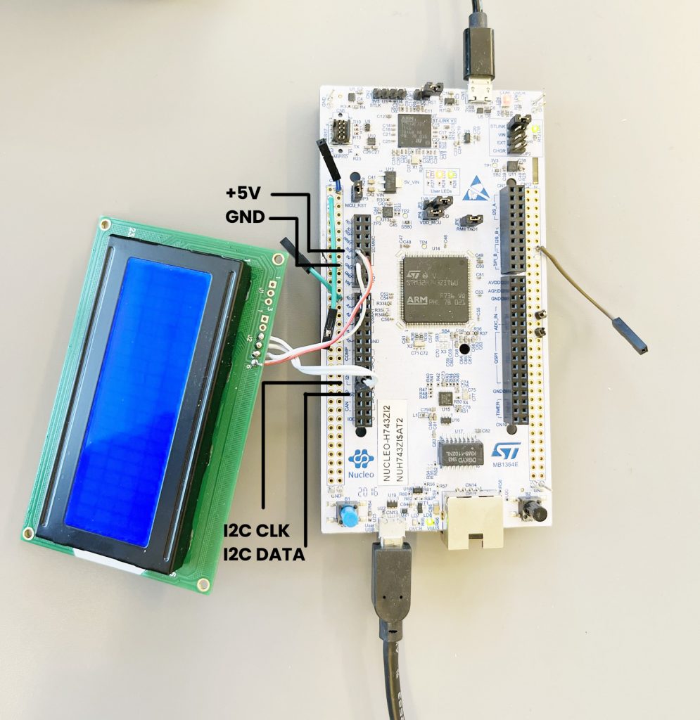

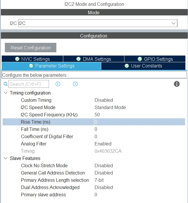

Connect the SDA to PF0 on the Nucleo board and SCL to PF1.
Then setup I2C2 in the STM32Cube ioc file as follows. (Make sure to change the I2C speed frequency to 50 KHz as per LCD display requirements.)

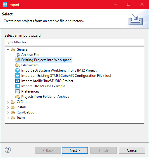

Using the example project
What we will need:

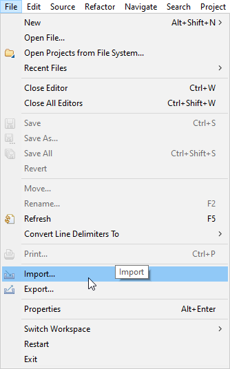

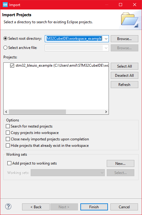

Importing as an Existing Project
From STM32CubeIDE choose File>Import…
Then choose General>Existing Projects into Workspace then click ‘Next >’
Make sure you’ve chosen your workspace in ‘Select root directory:’
You should see the project “stm32_bleuio_SHT85_example”, check it, and click ‘Finish’.

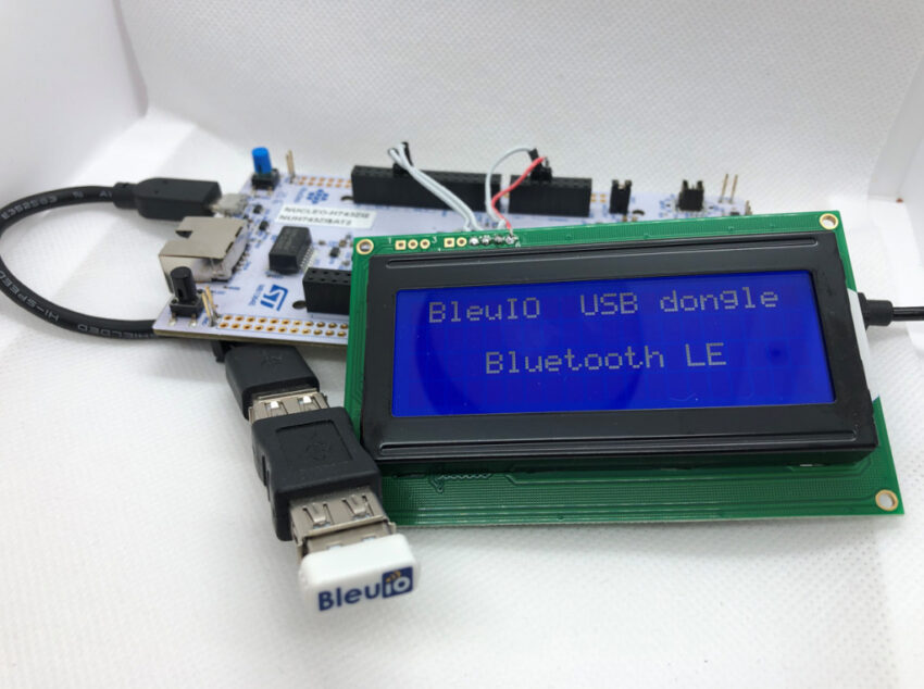

Running the example
Upload the code to STM32 and run the example. The USB dongle connected to STM32 will start advertising automatically.

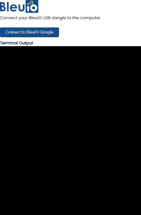

Run the web script

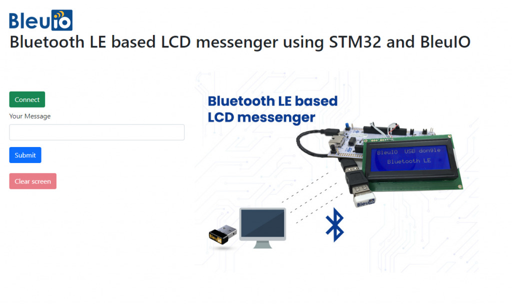

You will need a web bundler. You can use parcel.js
Once parcel js is installed, go to the root directory of the web script and type “parcel index.html”. This will start your development environment.
Open the script on a browser. For this example, we opened http://localhost:1234
You can easily connect to the dongle and send your message to the LCD screen. The response will show on the browser console screen.
The web script looks like this
Output
The message will show on the LCD screen.
