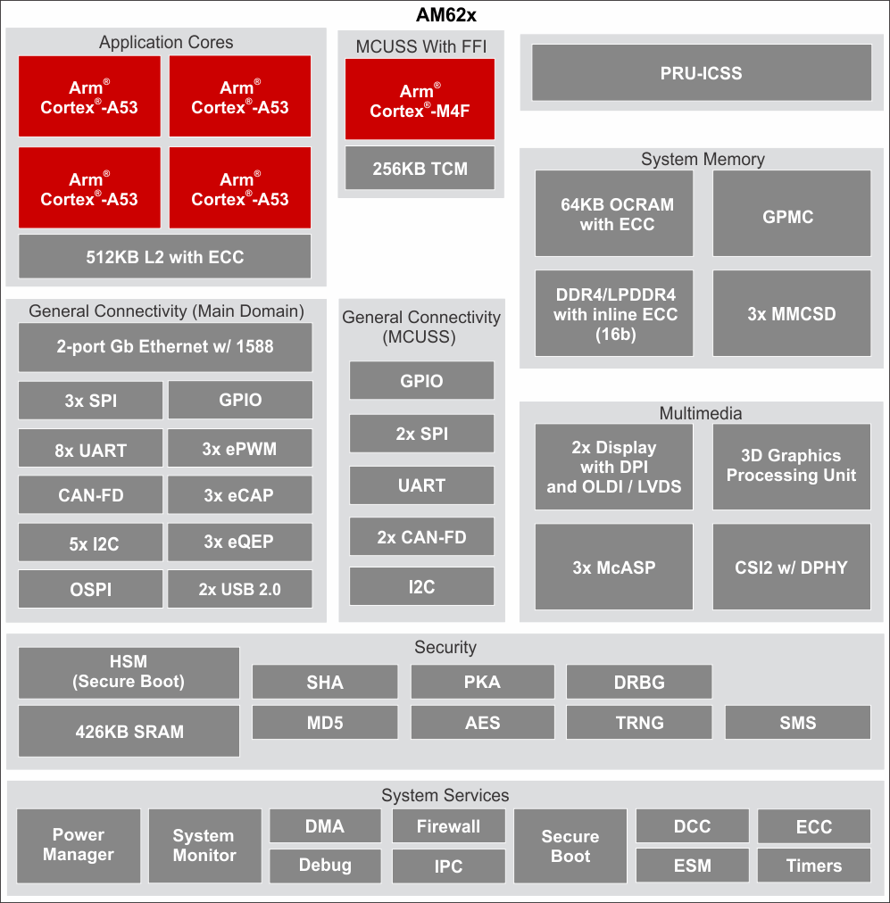

Block Diagram of Sitara AM62x Processor
Technical Specifications of Sitara AM62x
  • Arm CPU – The powerful performance comes from the single, dual or quad-core Arm Cortex A53 processors, which can run up to a maximum 1400MHz.
  • Co-Processor- A single real-time highly efficient embedded processor ARM Cortex-M4F core clocked up to 400 MHz.
  • Memory- It uses the 4th generation of low-power DDR DRAM (LPDDR4) and DDR4 with a memory option of 4GB/ 8GB, respectively.
  • Storage- OSPI/QSPI interface with 166-MHz DDR / 200-MHz SDR for Serial NAND and Serial NOR flash devices.
  • Connectivity- It supports Gigabit Ethernet with the support of TSN.
  • Operating system- Linux/ Android
The GPU used in this new series of AM62x is not yet specified by the company, but it is known that they have used an unnamed 3D GPU.
