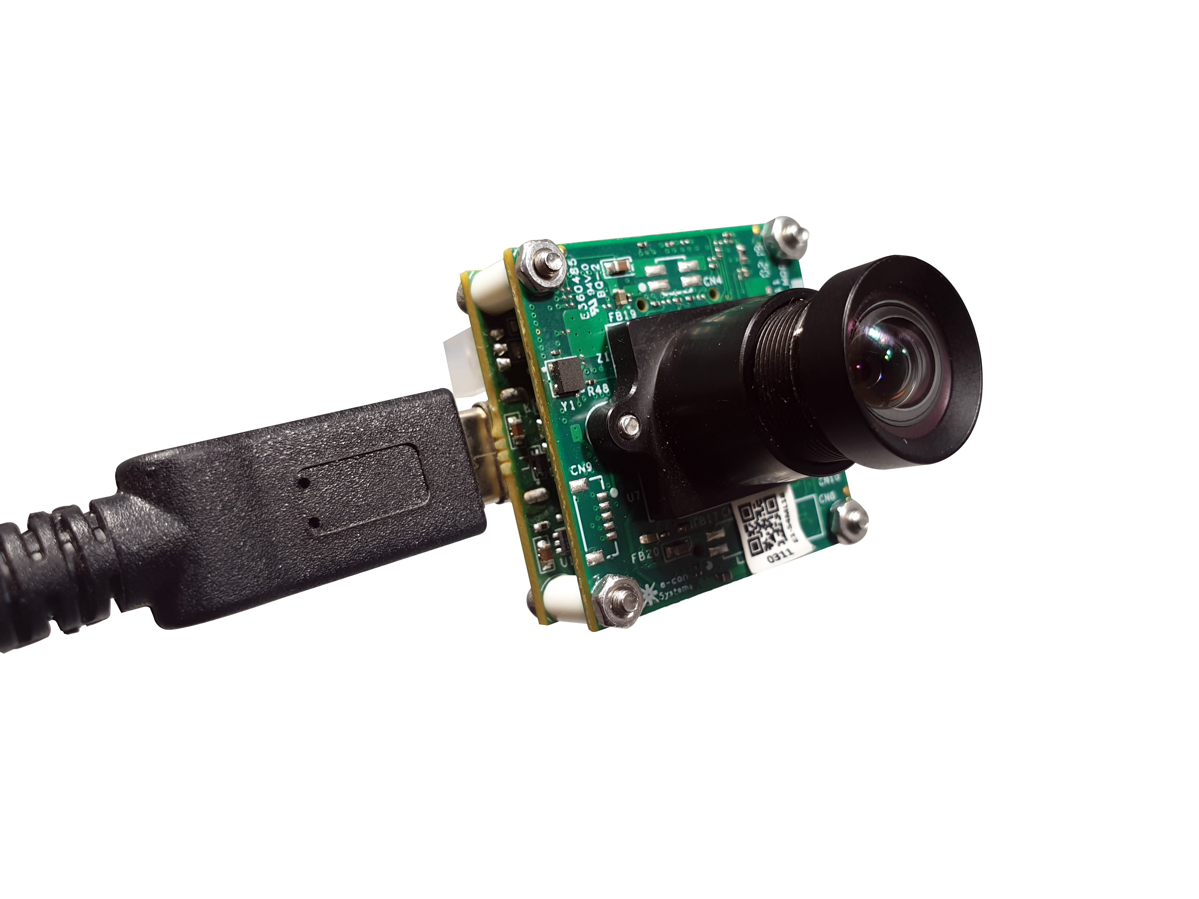

Fig:1 See3CAM_CU55M – 5MP Monochrome USB 3.1 Gen 1 Camera

The latest Monochrome member of the See3CAM family of USB 3.1 Gen 1 SuperSpeed camera products also comes with S-mount lens holder and a reversible plug and play Type-C connector interface. Supported by native UVC drivers of Windows and Linux Operating Systems (OS), it is a UVC compliant camera and does not require any drivers to be installed on the PC.

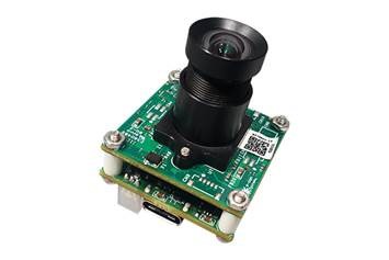

Specifications:
  • Houses e-CAM56_CUMI0521_MOD – 5.0 MP AR0521 Monochrome Camera Module
  • Fixed Focus with M12 lens holder
  • Electronic Rolling Shutter
  • Output format: Y8 (8 bits/pixel) and Y12 (12 bits/pixel)
  • Plug-and-Play setup (UVC compliant) for Windows 8.1/10 (both 32-bit and 64-bit) and Linux (ubuntu 14.04, 16.04 & 18.04)
  • Supported OS – Windows 8.1/10 (both 32-bit and 64-bit) and Linux (ubuntu 14.04, 16.04 & 18.04)
  • USB3.1 Gen1 device with Type C reversible interface connector
  • Operating Voltage : 5V +/- 5%, Current – 235mA
  • Operating Temperature Range * : -30°C to 70°C (ambient temperature)
  • Power requirements:
    • Max : 1.175W
    • Min : 0.780W
  • 10 pin GPIO Header
  • Support for External Hardware Trigger Input
  • Size in mm (L x W x H) – 30 x 30 x 30.2 mm (without lens)
  • Board Weight – 13.5 Grams (with out lens)
    21.5 Grams (with lens)
  • RoHS compliant
