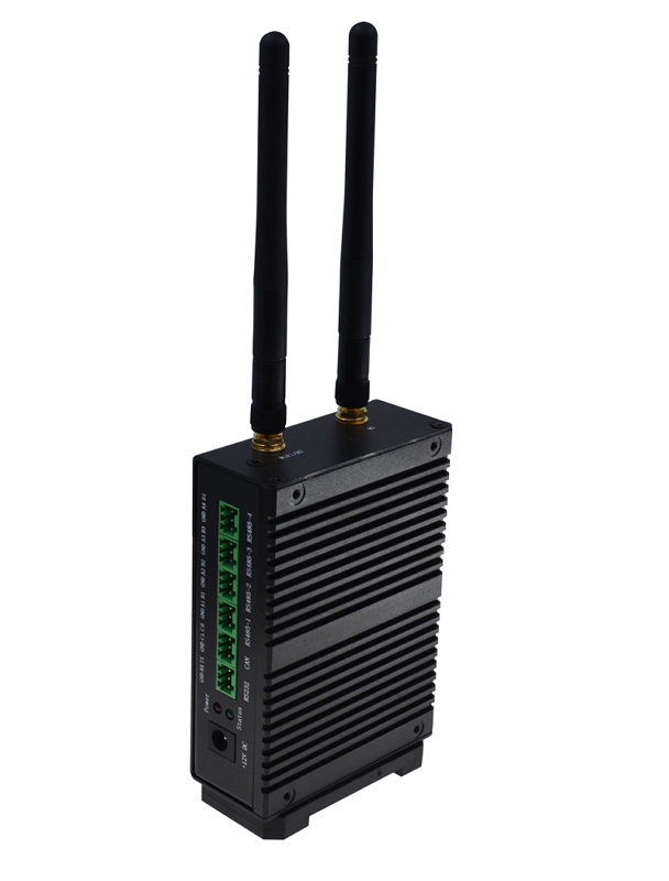

EDATEC CM4 Sensing is an industrial computer designed for IoT & Data Acquisition applications based on Raspberry Pi Compute Module 4. It utilizes the structural flexibility of CM4 to solve the heat dissipation problem of the CPU, wireless module, and PMU. The external antenna also improves the reliability of wireless communication, in other words, this can serve as a wireless booster for your computers.

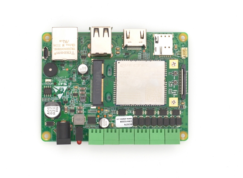

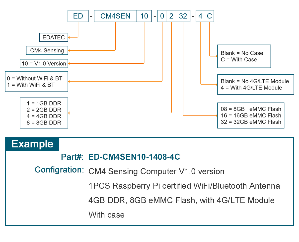

This system can be tailored to different applications with the choice of 1GB/2GB/4GB/8GB RAM, 8GB/16GB/32GB eMMC, 2.4/5.8G dual-band WiFi, Bluetooth (optional), and external antenna functionality. For applications that demand massive data storage, users can install the operating system and store application data with eMMC, whilst also using an SD card for storing larger user data. This ultimately offers more capacity than a built-in eMMC memory, at a more cost-effective price.

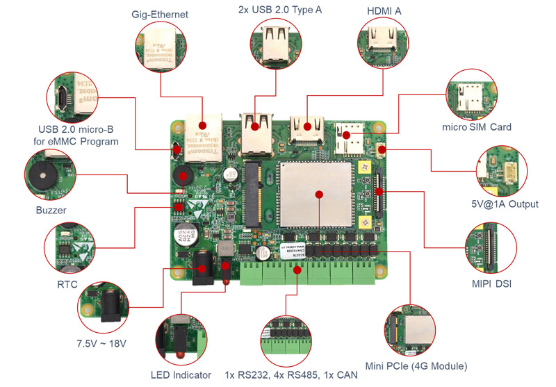

CM4 Sensing offers a 4G/LTE module, 4 RS485 channels, 1 RS232 channel, 1 CAN channel, 1 Gigabit Ethernet port, an alarm buzzer, and a battery-powered real-time clock. The CM4 Sensing’s DSI Interface is fully compatible with Raspberry Pi4 Model B and supports its official 7″ touch display. It also provides 5V/1.5A power output to power the Pi Display and outputs 4K HD video via its Standard HDMI interface. CM4 Sensing is equipped with 2 USB 2.0 channels and 1 Micro USB 2.0 channel, with the Micro USB channel being for system image updates.
The CM4 Sensing is slightly larger than the Pi4 Model B, measuring 103 x 73 x  32mm, and it comes with connectors that exit from both the front and back. A 103 x 73mm x 5mm heatsink ensures optimal cooling performance for the CPU, wireless module and PMU, enabling it to function in a high-temperature environment. A series of testing has proven the CM4 Sensing to have a reliable operation at -25~60°C ambient temperatures. For extra convenience, 4 M2.5 screw holes are provided at the base of the case, enabling users to install their CM4 Sensing on other equipment or mount it on DIN rail or walls.
