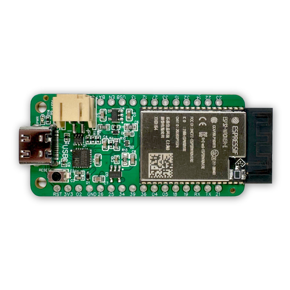

ePulse Feather, the low power ESP32 development board, is optimized for applications where a low sleep current and LiPo battery support is required. The VIN pin accepts voltages between 3V3 and 6V. When the ePulse board is in deep sleep it only consumes between 12uA (above 3.3V) and 27uA (below 3.3V). Most ESP32 and ESP8266 board consume around 100 – 130uA.
This low sleep consumption is perfect for applications where the device sleeps most of the time and only wakes up from time to time to complete a task. For instance, a WiFi remote control for home automation can sleep until the user presses one of the buttons. The device wakes up, connects to WiFi, sends the command over MQTT and goes back to sleep until the next time a button is pressed.
  • 12-27uA in deep sleep
  • VIN: 3.3 – 6V
  • ESP32-WROVER-E
  • 8MB PSRAM
  • 8MB Flash
  • Access to 20 GPIO pins
  • LiPo charging circuit
  • Follows Adafruit Feather form factor specification
  • Includes male header pins (1×12 and 1×16)
