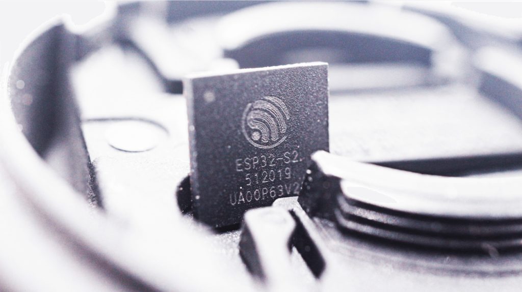

Back in 2019, Espressif announces the launch of ESP32-S2 SoC, which was an upgrade of the regular of ESP32 but targetted for security-focused applications. Unlike the typical ESP32, this new SoC comes with an array of new features.
Back in 2019, Espressif announces the launch of ESP32-S2 SoC, which was an upgrade of the regular of ESP32 but targetted for security-focused applications. Unlike the typical ESP32, this new SoC comes with an array of new features. Fasttrack to February 2020, Espressif has announced that the ESP32-S2 SoCs have now been cleared for mass production and will be expecting devices based on the new SoCs coming to market soon.
Unlike the original ESP32, the ESP32-S2 SoC is equipped with a faster 240 MHz Xtensa® 32-bit LX7 single-core processor but comes with 320 KB of SRAM and 128 KB of ROM which is lower than the 520KB of RAM and 448 KB of ROM of the ESP32. Nevertheless, this lower memory might not be an issue, and the S2 SoC supports for its shortcomings by proving support for bigger external memories. Also, the S2 comes with a ULP coprocessor based on the RISC-V architecture. With a single-core processor, the ESP32-S2 has lower power consumption, while maintaining excellent processing capabilities.
