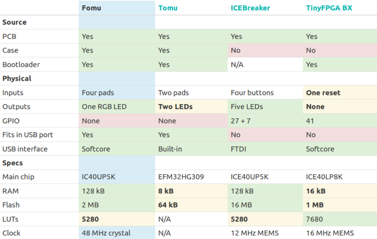

Fomu is now live on Crowd Supply, costing $39, with free shipping inside the United States, and an additional $5 for worldwide shipping. Want to get one? Or want to appreciate the Fomu team, then pledge them a beer on their CrowdSupply page.

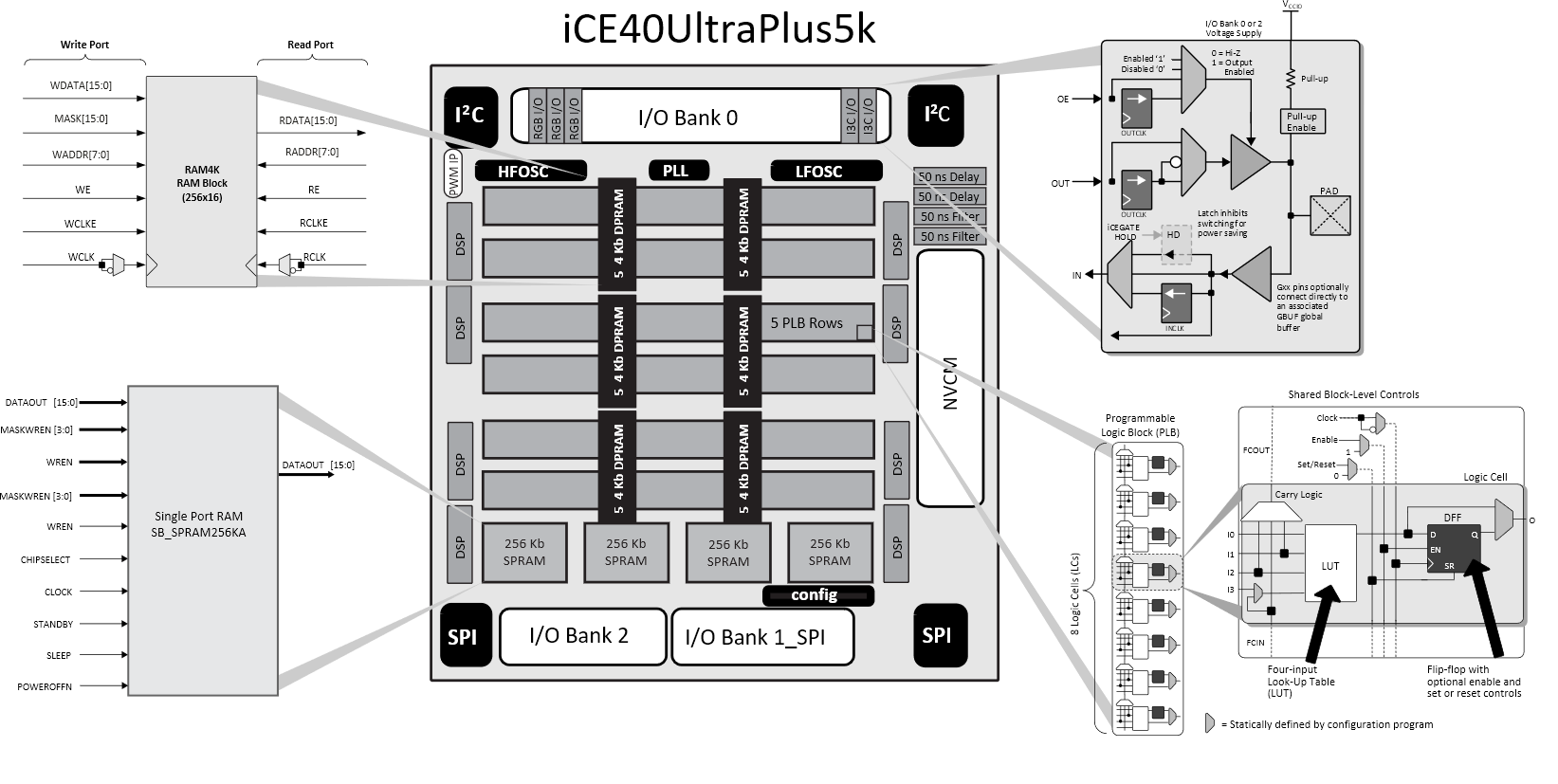

iCE40UP5K block diagram
