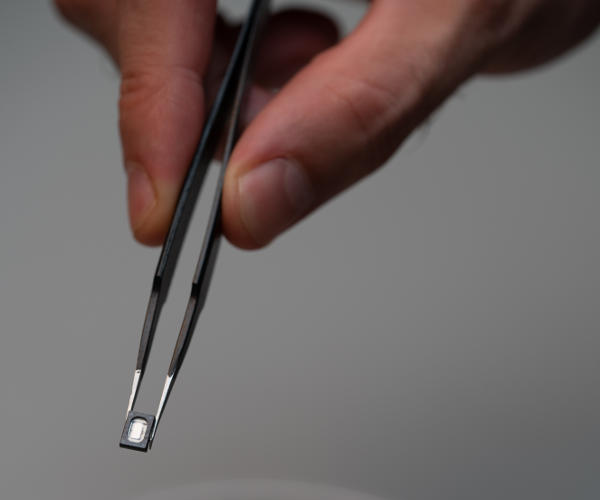

USound GmbH's Ganymede Achelous and Adap MEMS speakers with their compact size of 4.7 mm x 6.7 mm x 1.6 mm are ideal for in-ear headphone designs and wearables such as true-wireless headsets. The perfect addition to traditional speakers, they can be easily retrofitted into standard enclosures to improve treble or implement 3D audio systems.
USound GmbH’s Ganymede Achelous and Adap MEMS speakers with their compact size of 4.7 mm x 6.7 mm x 1.6 mm are ideal for in-ear headphone designs and wearables such as true-wireless headsets. The perfect addition to traditional speakers, they can be easily retrofitted into standard enclosures to improve treble or implement 3D audio systems.
Achelous is a MEMS speaker designed for occluded-ear headphones. It can also be used as a micro-tweeter for wearables and array applications. This speaker provides higher excursion and more damping ideal for in-ear designs. In free-field, the resonance is lower than Adap, which allows a lower crossover frequency.
Adap is a MEMS-based micro-speaker for occluded-ear headphones and can also be used as micro-tweeter for wearables and array applications. It is optimized as a tweeter with high SPL above resonance. The Adap has a higher resonance frequency.
