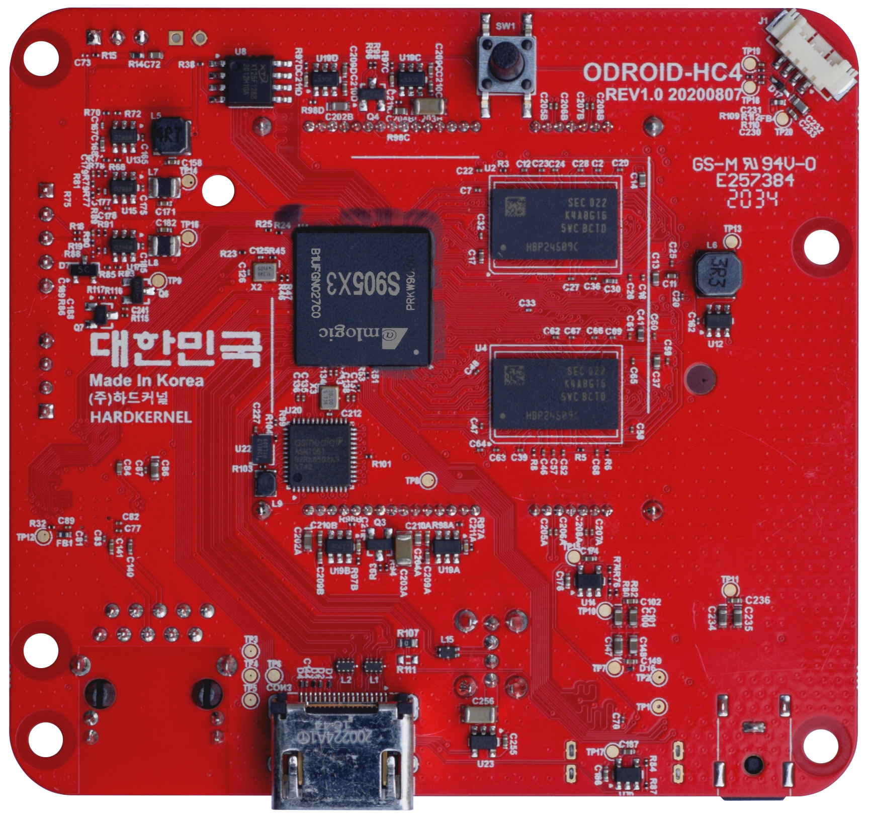

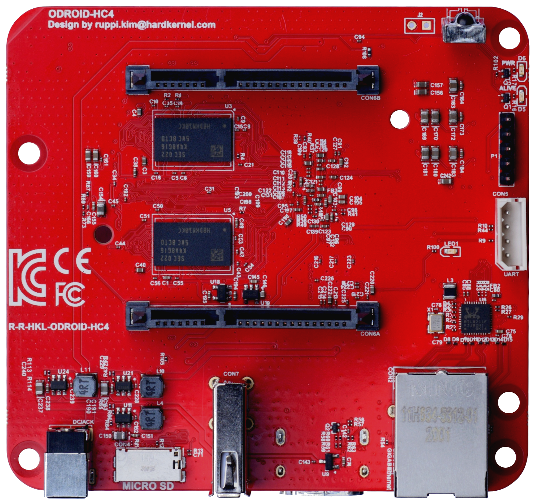

The new Odroid-HC4 however seems to be a powerful upgrade as the HC4 does not only switch to a more powerful Amlogic S905X3 processor but also adds a second SATA slot. For the first time also, the SATA slots are enabled via PCIe instead of USB, meaning a faster and more reliable operation.
“We’ve heard that many users wanted to run their storage server on a modern ARM 64bit platform with more DRAM memory, higher power efficiency and more storage capacity. Therefore, we started developing a new Home-Cloud platform late last year and it is time to show you something new based on the same ARM S905X3 CPU in the ODROID-C4”, says Hardkernel. “We connected a SATA SSD to the HC4 platform and measured the storage IO throughput. We could observe 390~420MB/s transfer speed which is quite good for many applications.”
Unlike most NAS systems, the ODROID-HC4 has what it takes to keep things running cool from the inside. It has a passive heat sink attached on top of Amlogic S905X3 processor and a 5V 4,000-RPM bearing fan that operates at 23.9 dBA. The drives can also be inserted into the case slots and exposed to open air rather than hidden away inside a metal or a plastic.
ODROID-HC4 is ideal for workgroups, single users and families members. The server centralizes data and enables users to share and stream multimedia files to desktop and mobile devices.
Key Features and Specifications of the new dual-bay NAS device include:
  • Amlogic S905X3 quad-core Cortex-A55 processor (1.8 GHz)
  • Mali-G31 MP2 GPU with 4x execution engines
  • 4GB DDR4 RAM
  • 128 Mbit SPI flash
  • 1x UHS-1 compatible microSD slot
  • 2x SATA-3 ports implemented through ASM1061 PCIe to SATA controller
  • 1x GbE RJ45 ports via Realtek RTL8211F PHY (supports 10/100/1000 Mbps)
  • 1x HDMI 2.0 up to 4K @ 60 Hz
  • 1x HDMI digital output
  • 7x GPIO pins for optional OLED display
  • 1x USB 2.0 host port
  • 1x UART serial console
  • 2x LEDs
  • 1x cooling fan
  • 1x boot switch
  • IR receiver for remote controller
  • 15V DC via barrel jack.
  • Dimensions: 84.0 mm x 90.5 mm x 25.0 mm
  • Weight: 280g including case, fan and heatsink.
