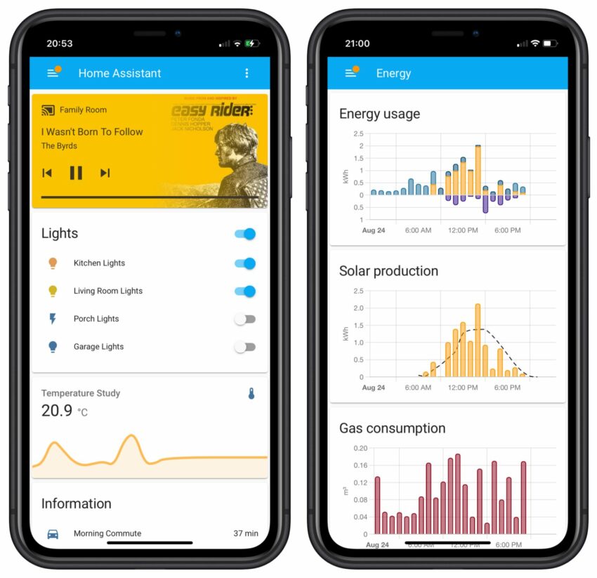

With Home Assistant Yellow, everything in the home can easily be automated. You can send a notification to turn on the lights of your home at a particular time, turn it off when you are about to sleep, or even confirm that your garage door which you left open should be closed. However you want to control your home devices, the Home Assistant Yellow will handle it. You can either use the pre-made automation templates that have been provided or you customize your own automations using the advanced automation editor. Also, you are not only able to integrate your devices but can get other useful details such as the air quality in your locality, the latest exchange rates, etc.

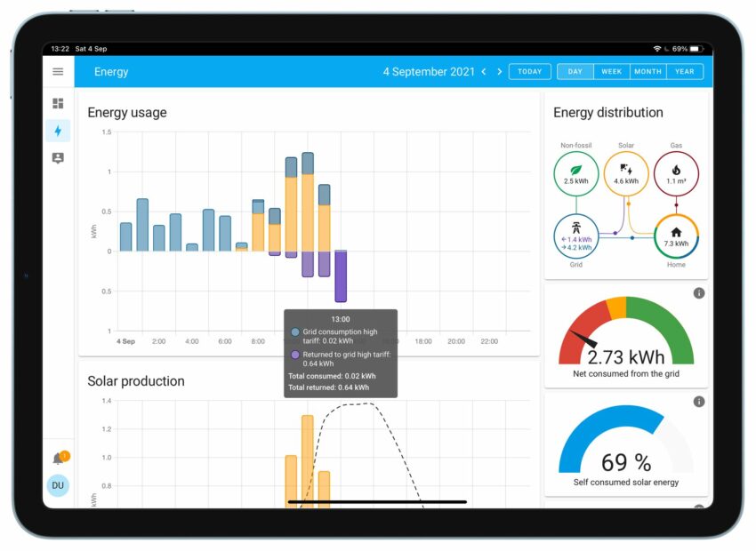

Another unique feature aside from allowing you to create powerful automations for nearly all your home devices and services, is that it gives insight into your energy usage. With Home Assistant Yellow, you can track and monitor your energy consumption and trends over time; solar panel, gas usage, or home batteries. It will be done using an interface that is easy to operate and runs 100% locally without anything in the cloud.

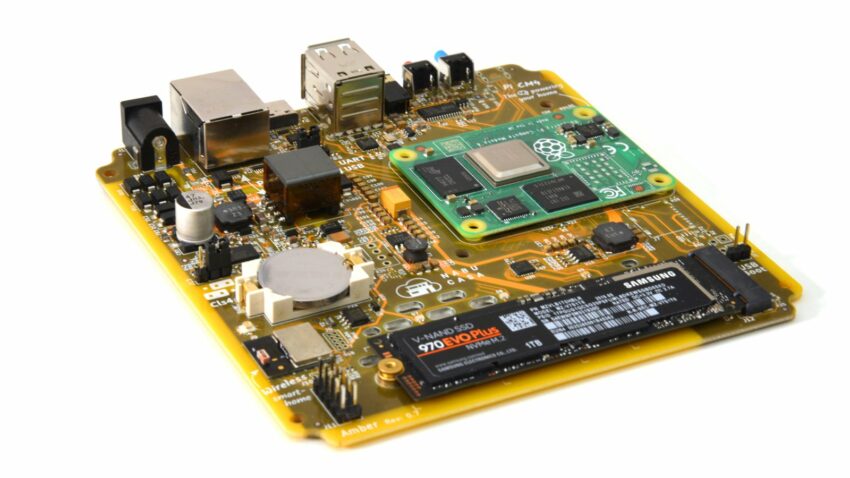

The Home Assistant Yellow also supports expandability and Scalability. It comes pre-installed with the 16GB of eMMC flash from the CM4, but as your devices grow and you begin to install more apps and collect more sensor data, you may need to upgrade the CM4 to a higher variant that has a larger storage capacity of 32GB eMMC flash or just install an NVMe SSD in the device’s M.2 extension port. You can also consider installing the CM4 that uses both WiFi and Bluetooth as the Home Assistant Yellow does not integrate any of these. It uses the most recent and greatest ZigBee radio chip for smart home wireless connectivity.

Carrier Board
  • Raspberry Pi CM4 board-to-board connector
  • Direct boot from NVMe devices
  • Size: 12cm x 12cm
  • Compatibility with all CM4 variants with 64-bit Quad-Core Cortex-A72 processor running at 1.5GHz; up to 8GB RAM and up to 32 eMMC
Smart-Home MGM210P Mighty Gecko Wireless Module
  • Supports Zigbee 3.0 and OpenThread
  • 2.4GHz radio with TX power of +20 dBm
  • 1MB flash memory
  • 96KB RAM memory
  • Upgradeable Zigbee 3.0 firmware preinstalled
Other Specs:
  • Gigabit Ethernet
  • Expansion slot for NVMe SSDs, M.2 socket M-key, PCIe
  • 2x USB 2.0 Type-A host port; 1x USB-C 2.0 device port
  • Stereo audio DAC
  • RTC backed by CR2032 battery
  • 2x Push Button
  • Status LED
  • Power: 12V / 2A through barrel DC power jack
  • Enclosure: 123 mm x 123 mm x 36 mm; includes custom heatsink
