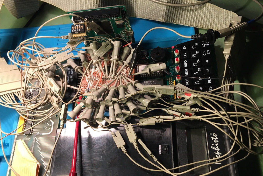

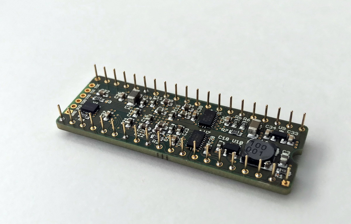

He started by designing a circuit board that is the same size as a 40-pin dual inline package and has pins that correspond to the 65C02 pinout. This board was then fitted with a Spartan-6 FPGA and 64 kByte of on-chip RAM. He implemented logic within the FPGA that is able to interact with the external 65C02 bus in accordance with the clock signal from the host system. The CPU core within the FPGA clocks at a speed of 100 MHz. The goal is to create a single accelerator that can be used with 6502 and 65C02-based host computers, simply by plugging it into the CPU socket.
The FPGA board must be aware of the memory map of its host in order to determine where the host has memory-mapped I/O. It can store up to 16 different memory maps and switch between them using a mini DIP switch. When the 65F02 is turned on, it takes all of the RAM and ROM content from the host and stores it in its own internal RAM, excluding the I/O area. Once the CPU is running, the internal memory is accessed at 100 MHz for all bus operations, except for I/O addresses. In this case, the CPU will pause and an external bus cycle will be initiated at the external clock rate.
