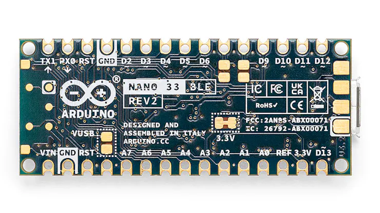

The Arduino Nano 33 BLE Rev2 maintains the same size as the original version, but some hardware changes may require sketch adjustments. The major change is the use of two separate inertial measurement units (IMUs) instead of a single nine-axis unit. The new IMUs include the Bosch Sensortec BMI270 six-axis IMU and BMM150 three-axis magnetometer.
The power circuitry has also been upgraded to the Monolithic Power MP2322 step-down converter, promising improved performance. The board also features a VUSB solder jumper for enabling the VUSB pin, along with new pads and test points for accessing USB, SWDIO, and SWCLCK signals.
However, the board’s processor remains unchanged: the Nordic Semiconductor nRF52840, which offers a 32-bit Arm Cortex-M4 core running at up to 64MHz, 256kB of static RAM (SRAM), and 1MB of flash storage. These specifications ensure powerful processing capabilities for various applications.
The board retains the footprint of the original, though now includes pads for USB, SWDIO, and SWCLCK signals. (📷: Arduino)
