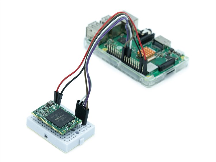

The new release from Skudo is a professional FGPA development board built as an encryption solution to project boards like Raspberry Pi, Arduino, and BeagleBone. It is a plug and play Hardware Security Module that provides a compact pre-configured FPGA chip with functionalities for encrypting data, and can easily be used by any maker board.

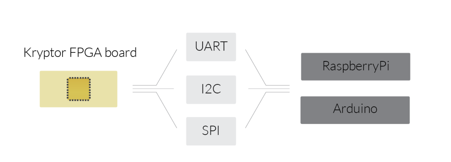

“Any controller board (e.g. Raspberry Pi, Arduino etc.) can be connected to the Kryptor PCB via SPI, 12C and UART using a simple data protocol (free Linux API software libraries are also provided) enabling access to the functionalities of the Hardware Security Module (symmetric encryption, asymmetric encryption, hashing, keys generation/storing/management and a True Random Number Generator). Any maker is able to access those functionalities and build complex solutions based on them”.
Being able to offload an encryption work via 12C, SPI, or UART to your application helps you to focus more on the application’s code and worry less about implementing encryption.
“To make the Kryptor easy to use for IoT developers and makers, we also provide a free and easy-to-use API for Linux (e.g compatible with Raspberry Pi), which lets almost anyone start working with Kryptor in mere minutes,” Skudo adds.
