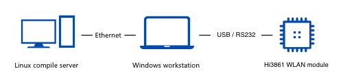

Setting up the Hi3861 IoT development board to run the HarmonyOS is extremely easy, and requires minimal tools including a Linux compile server, Windows workstation (host computer), Hi3861 WLAN module, and a USB Type-C cable to connect the board to the host computer.
Flow of HarmonyOS Device
