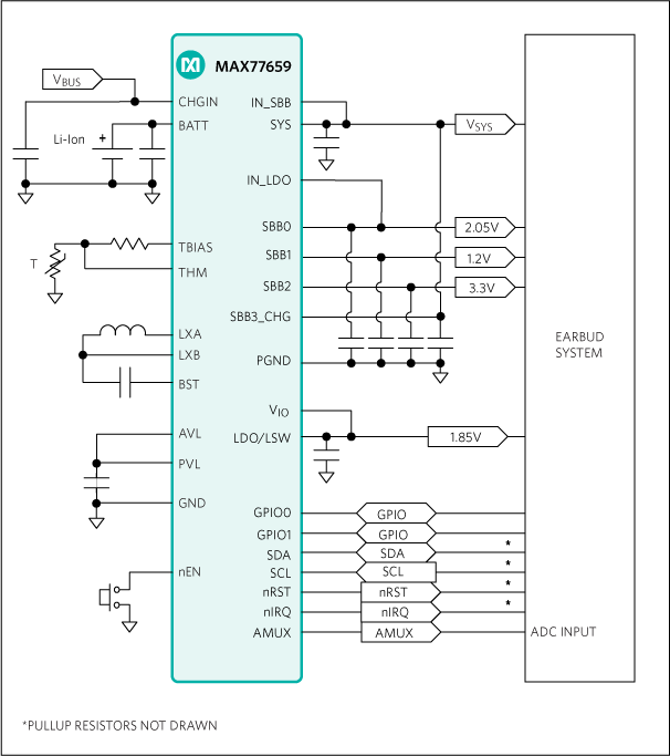

Maxim Integrated MAX77659 SIMO Power Management IC (PMIC) is optimized for rechargeable earbuds, wearables, and other applications that emphasize low supply current and small solution size. The MAX77659 features a dual-input Single-Inductor Multiple-Output (SIMO) buck-boost regulator.
Maxim Integrated MAX77659 SIMO Power Management IC (PMIC) is optimized for rechargeable earbuds, wearables, and other applications that emphasize low supply current and small solution size. The MAX77659 features a dual-input Single-Inductor Multiple-Output (SIMO) buck-boost regulator. The device provides one charging rail and three independently programmable power rails from a single inductor to minimize the total solution size. A 100mA LDO provides ripple rejection for audio and other noise-sensitive applications. The LDO can also be configured as a load switch to manage power consumption by disconnecting external blocks when not required. A highly configurable switching charger supports a wide range of Li+ battery capacities and includes battery temperature monitoring for additional safety (JEITA).
This MAX77659 PMIC includes two GPIOs and an analog multiplexer that switches several internal voltages and current signals to an external node for monitoring with an external ADC. A bidirectional I2C serial interface allows for configuring and checking the status of the device. An internal on/off controller provides a controlled startup sequence and provides supervisory functionality for the regulator. Numerous factory programmable options allow the device to be tailored for many applications, enabling faster time to market.
The Maxim Integrated MAX77659 SIMO PMIC is offered in a compact 6.04mm x 6.04mm Wafer-Level Package (WLP) ideal for space-constrained applications.

Application Circuit
