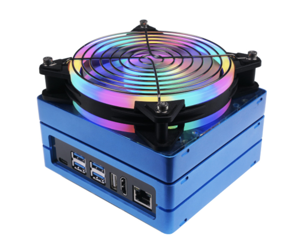

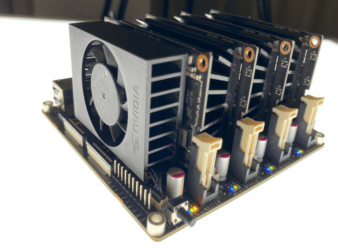

All of these are however set to change, as Seeed Studio, the popular Shenzhen-based Electronics component manufacturer, last week, announced the launch of the Jetson Mate; a carrier board kit that allows users to create a cluster with up to 4(four) Jetson Nano or Jetson Xavier NX modules, leveraging on the pin compatibility nature of both modules.

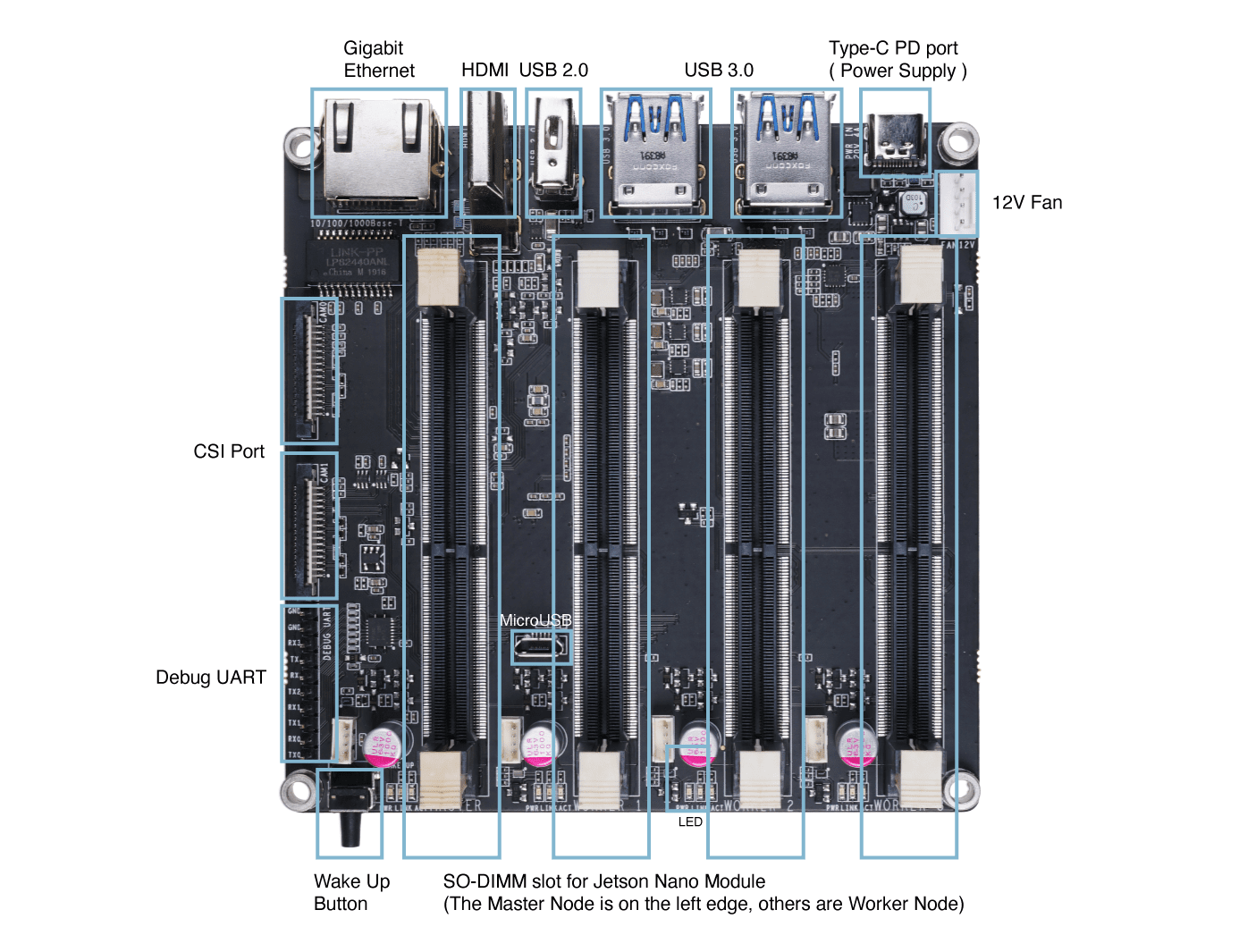

Unlike the previous attempts at the problem, the Jetson mate comes in a high-quality, production-ready, fancy enclosure.  The mate features SODIMM slots for 4 SOMs one of which is designated to serve as the slot for a master module while the other modules are designated as workers. As you will expect, certain features like software upload, are peculiar to the master slot, but performance across the board in terms of processing is fairly the same, with the master only serving as an entry point to the cluster. Each of the worker SOMs can be powered on or off separately, filling the need for applications that need to switch between SOMs.
Communication between the SOMs and the outside world (internet or Local) is enabled by an onboard 5-port gigabit switch which enables the 4 SoMs to communicate with each other, with the last port of the switch used for uplink connection to a network via an onboard Gigabit Ethernet port.

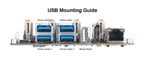

In addition to the ethernet port, the Jetson mate features 1 USB 2.0 port which connects to the Master node, and 4 USB3.0 ports one of which is also connected to the master and the other 3 to each of the worker nodes. The mate also features 2 CSI ports for possible camera connections, a UART debug port, a USB-C port which can be used for OS Upload among others, and a 4-pin port to which the giant 12v fan at the top of the kit is connected.
