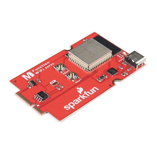

MicroMod WiFi Function Board
The second board, the SparkFun MicroMod WiFi Function Board – ESP32 is designed to serve as a coprocessor board, utilizing ESPRESSIF’s ESP32 WROOM (ESP32-DOWD-V3 Chip) to add WiFi and Bluetooth wireless features to original MicroMod processor boards without such features. The onboard ESP32 WROOM is equipped with 16MB Flash, 520KB SRAM, a dual-mode Bluetooth, an IEE802.11b/g/n WiFi transceiver, and an M.2 MicroMod interface to aid connection without inter-board soldering. The board also features a UART port that can be used to control the ESP32 WROOM module via AT commands, USB-C connector, and CP2102 USB-to-Serial converter.

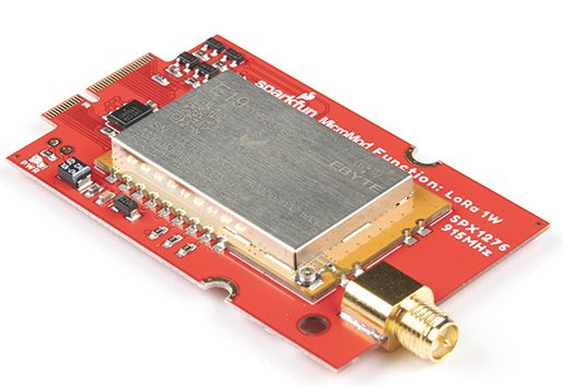

MicroMod LoRa Function Board
The next Board, SparkFun MicroMod LoRa Function Board, is expected to be used alongside a MicroMod processor board on a Main Board (Host) that offers LoRA and LoRaWAN network capabilities for any MicroMod development. The Main Board is designed to host the duo attachments and provide an electrical connection between them. The LoRa Function Board features Ebyte’s LoRa 915M30S module, a 30dBm transceiver utilizing Semtech SX1276 Communication protocol. It has an edge mount RP-SMA connector suitable for 915MHz LoRa antennas, and a U.FL interface.

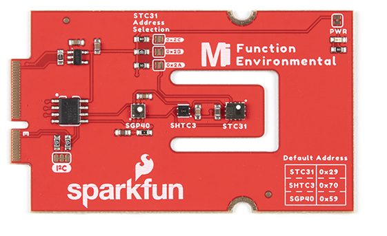

MicroMod Environmental Function Board
The last function board, the SparkFun MicroMod Environmental Function Board provides sensing capabilities to MicroMod processor boards with an SGP40 sensor for air quality sensing, an SHTC3 sensor for temperature and humidity sensing, and an STC31 sensor for sensing CO2 concentrations in your room. This Board features an I²C port, an AP2112 3.3V voltage regulator, and jumpers for selectively addressing the STC31.
