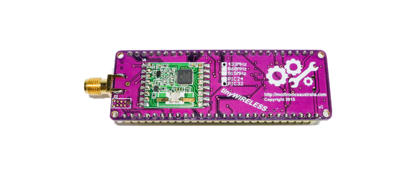

tinyWireless PIC32 Board Front
This flexible development platform supports the long-range ISM band RFM69HW wireless transceiver. It has wireless transmission speeds of up to 300kbps with AES-128 bit encryption to prevent wireless sniffing. Depending on the data rate and RF environment, these modules can communicate over many kilometers. What makes it even more remarkable is that the RFM69HW is programmable in both narrow-band and wide-band communication modes without the requirement for external components to be modified.
tinyWireless PIC32 Board Back
The RFM69HW module is also a perfect alternative for battery-powered applications due to its wide operating voltage range of 1.8–3.6 V and low current consumption. Plus, the module gives a +20dBm output power and can be purchased in 433MHz, 868MHz, or 915MHz frequency variations. Furthermore, tinyWireless has a 32Mbit SPI FLASH and USB or UART ports for communication with your PC, making it ideal for data logging applications.
