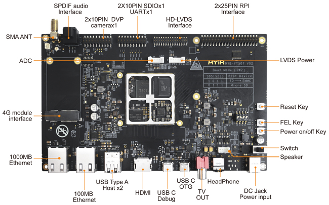

MYD-YT507H Development Board Top-view (delivered with shieldinig cover by default)
MYIR provides theMYD-YT507H Development Board for evaluating the MYC-YT507H CPU Module, its base board has explored a rich set of peripherals and interfaces such as Serial ports, one Gigabit Ethernet and one 10/100M bps Ethernet, two USB 2.0 HOST and one USB 2.0 OTG, one TF card slot as well as a USB based 4G Mini PCIE interface. It has a DVP camera interface and a MIPI-CSI interface to allow connecting with camera modules. It also supports multi video output interfaces such as dual LVDS, HDMI and CVBS OUT, to achieve different display in dual screens. The board is delivered with necessary accessories, detailed documentations as well as optional MY-CAM002U USB Camera Module, MY-CAM011B DVP Camera Module, MY-CAM003M MIPI Camera Module, MY-WIREDCOM RPI Module (RS232/RS485), MY-WF005S WiFi/BT Module and MY-LVDS070C LCD Module, which makes it ideal for evaluating and prototyping based on ALLWINNER’s T507-H processor.

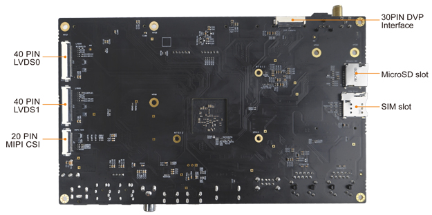

MYD-YT507H Development Board Bottom-view

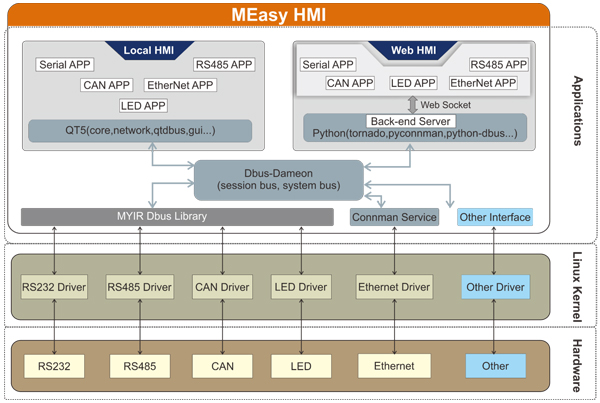

The MYC-YT507H Module is ready to run Linux OS. MYIR provides abundant software resources for Linux 4.9 based MYIR MEasy HMI V2.0 system with QT5.12.5, Ubuntu 18.04.5 system, including kernel, driver source codes and compilation tools to enable users to start their development rapidly and easily.
MEasy-HMI System Structure

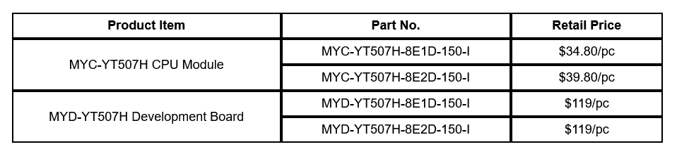

MYIR offers RAM options for CPU Modules and Development boards. The prices are economic. Discount is to be offered for volume quantities.
