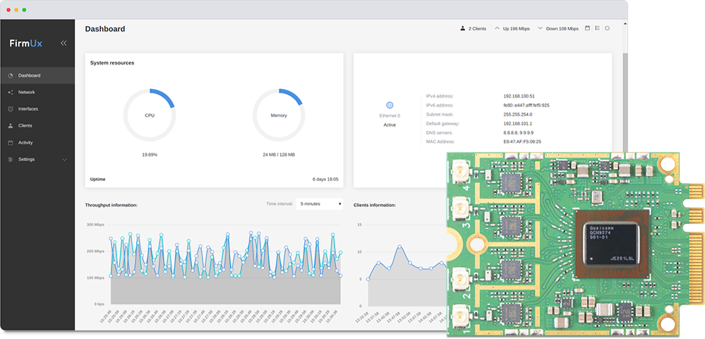

The Noni module, powered by Qualcomm’s QCA9274/QCA6274 chipsets, revolutionizes wireless connectivity with advanced WiFi-7 capabilities packed into a versatile M.2 A+E form factor. Tailored for a diverse range of applications, this module thrives in both commercial and industrial environments, delivering consistent performance across various conditions.
In adherence to the IEEE 802.11be standard, the Noni module achieves remarkable data rates of up to 11 Gbps. Its flexible MIMO arrangements, available in 4×4 or split 2×2 + 2×2 setups, accommodate diverse network configurations, while support for channel sizes up to 320 MHz and 4K QAM modulation elevates both efficiency and quality of wireless connections.
Equipped with Multi-Link operation for simultaneous multi-frequency communication and adaptive interference puncturing, the Noni module optimizes bandwidth utilization even in challenging environments. Its dual-band support across 5GHz and 6GHz spectrums ensures adaptability to evolving wireless demands.
Key specifications include wide frequency band support and a PCI Express 3.0 dual-lane interface, enhancing compatibility across various form factors like mini-PCIe, System on Module (SoM), and M.2 A+E. Security remains paramount with support for robust protocols like WPA3 and comprehensive encryption standards including AES-CCMP/GCMP, ensuring secure wireless communication. For seamless software integration, the Noni module offers support for both FirmUx and QSDK, providing developers the flexibility to choose between open-source or proprietary drivers. This dual compatibility streamlines firmware development and facilitates effective device operation management.
Available on the 8devices website, the Noni module comes in several variants. The Noni 56 M2-4×4-I is priced at $85.00, offering advanced features for specialized applications. Meanwhile, the standard Noni 56 M2-4×4 is available for $79.00 catering to general-purpose wireless needs. For budget-conscious projects, the Noni 56 M2-4×4-B variant is offered at $74.00, providing reliable connectivity at an affordable price point.
