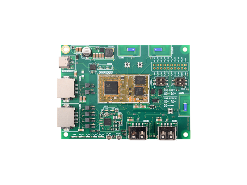

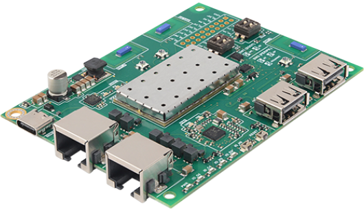

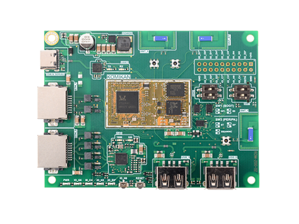

Komikan DVK
The Komikan module support 2x USB, 4x UART (1x for BT), RGMII, 2x SPI, PWM, MDIO, eMMC, JTAG, 2x I2S, PCM, 2x I2C, and P-NAND. The module also enables 44x GPIO pins, with several pins supporting an external antenna. Its 3.3V module outputs power at “22 dBm per chain.” The Komikan DVK board features an eMMC socket and a microSD slot, to expand the Komikan module’s memories.
The board offers both 10/100 and 10/100/1000Mbps (GbE) ports, a 2x USB 2.0 host ports, and a USB Type-C for power and UART console duty. The dev board is also equipped with dual 2.4GHz/5GHz WiFi antennas, a Bluetooth antenna, reset and GPIO buttons, and dip switches. Available also is a 20-pin GPIO header. The $29 Komikan module and $59 Komikan DVK are available for pre-orders with shipping starting from May 15.
