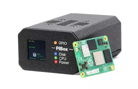

The PiBox 2 Mini with a modular design is a network data storage server built on a Raspberry Pi CM4 board with up to 8GB RAM and 32GB eMMC flash. The PiBox is designed to function as a standard NAS and specifically provide support for home-based private cloud hosting applications capable of replacing popular cloud storage solutions/services like Dropbox and Google photos with easily installable templates (apps/services) available in/for the box. It is furnished with two slots for 2.5″ HDD and SSD compatible drivers, USB ports, and an HDMI port to also function as a computer.
The box features a PCIe carrier board that carries the Raspberry Pi CM4, a PCIe slot for the Raspberry Pi CM4, and a SATA board with interfaces that I already mentioned. The carrier board also exposes a 40-pins GPIO header and a Gigabit Ethernet port. It requires a supply power of 5V/3A. Board specification references Jean-Luc’s content on Cnx Software.
