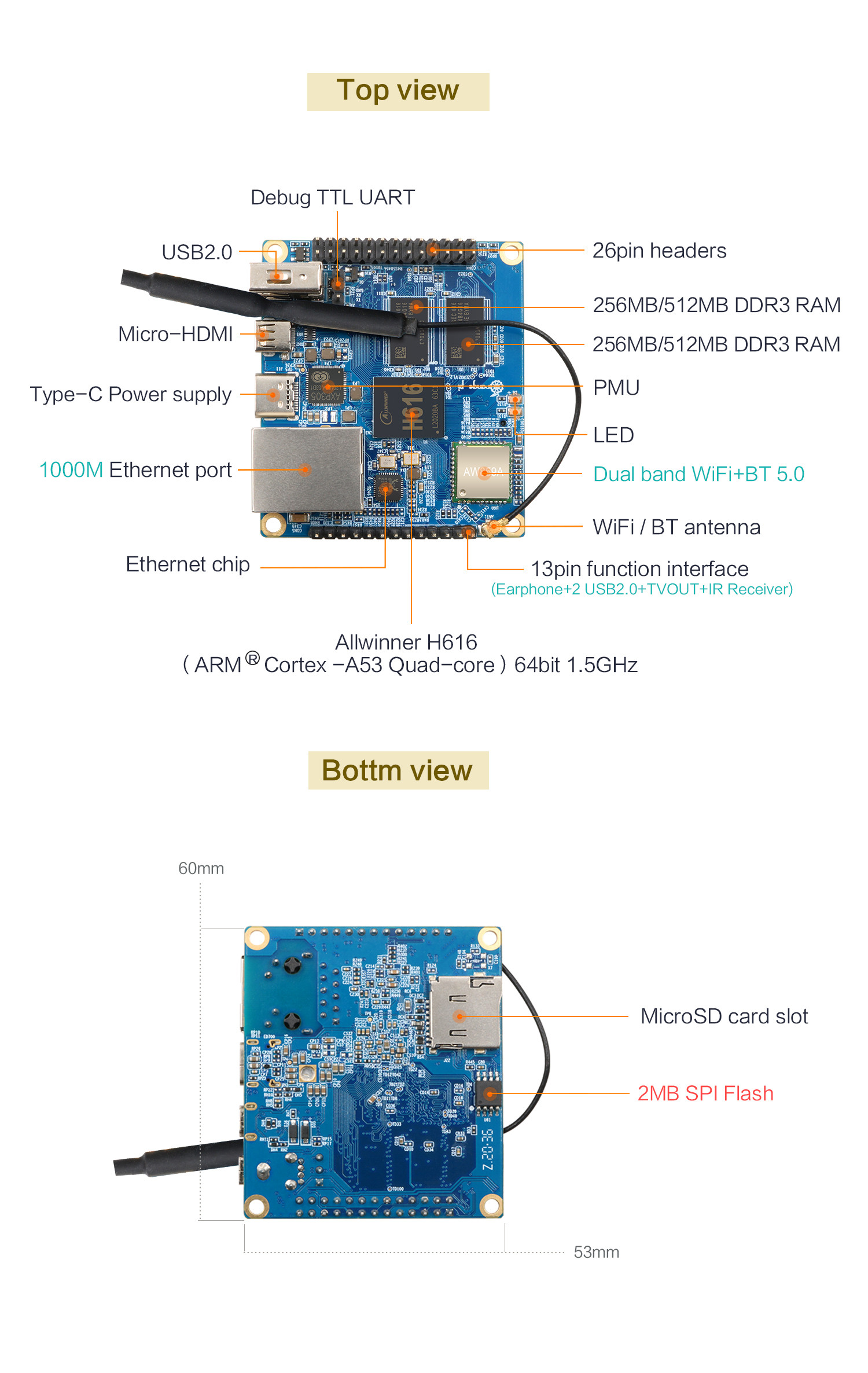

The Orange Pi Zero 2 is an alternative to the Pi Zero, and has been unveiled over a year ago, but only now has started shipping orders. It build upon its predecessor by switching from an ARM Cortex-A7 based processor, the Allwinner H2, to a much faster, Cortex-A53 based Allwinner H616 (clocked at 1.5 GHz), which blows the Raspberry Pi Zero right out of the water in terms of performance for about the same price and a less rectangular, but just a tad bit bigger size, coming at a size of 60 x 53 mm (compared with the 66 x 30 mm of the Raspberry Pi Zero). Besides that, it offers you the option for 512 MB or 1 GB of RAM, and upgrades its predecessor Orange Pi Zero in almost every level: processor, RAM, adds Bluetooth 5.0, faster Wi-Fi and ethernet, provides a micro HDMI interface and switches its power to USB type-C, instead of micro USB.
Looking at its specs in greater detail:
  • Allwinner H616: 64-bit quad-core ARM Cortex-A53 processor, clocked at 1.5 GHz
  • Mali G31 MP2 GPU: Supports OpenGL ES 1.0 / 2.0 / 3.2 and OpenCL 2.0
  • Memories: 512 MB / 1 GB DDR3 RAM (shared with the GPU) + 2 MB SPI Flash + SD card storage
  • Connectivity: Dual band Wi-Fi, Bluetooth 5.0 and 10M / 100M / 1000M ethernet
  • Video output: Micro HDMI 2.0a up to 4K@60 fps and TV CVBS output (support for PAL / NTSC) via 13 pin interface board
  • 3x USB 2.0 host (2 of them via 13 pin interface board)
  • Peripherals: 26 pin header with I2C, SPI, UART and GPIO ports + 13 pin header with 2x USB host, IR pin, TV-out, audio (no mic) and 3 GPIO ports
  • Power: 5V 2A via USB Type-C interface
  • Support for Android 10, Ubuntu and Debian
  • 53 mm x 60 mm dimensions and weight of 30 grams
A detailed view of the Orange Pi Zero 2
