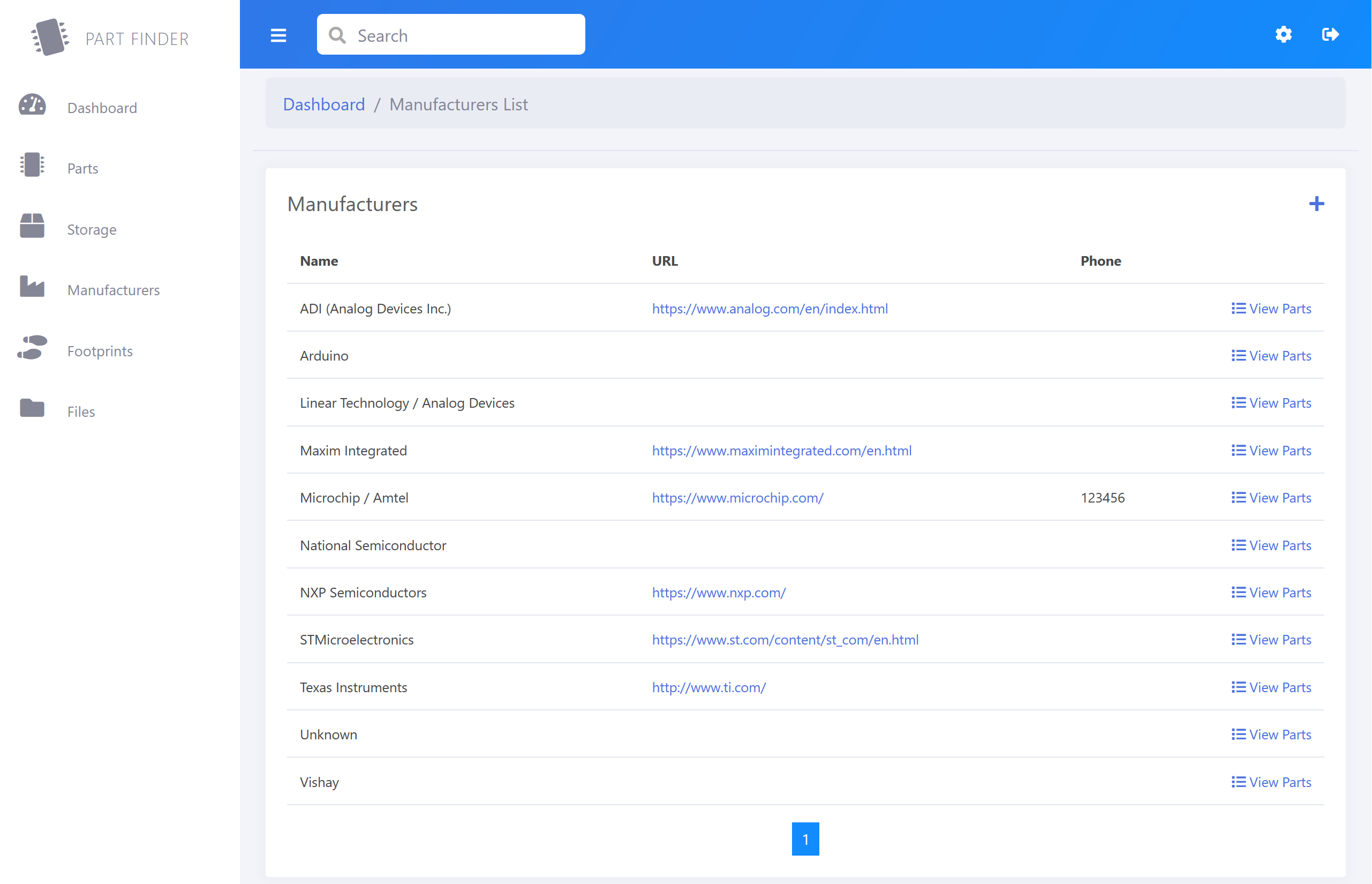

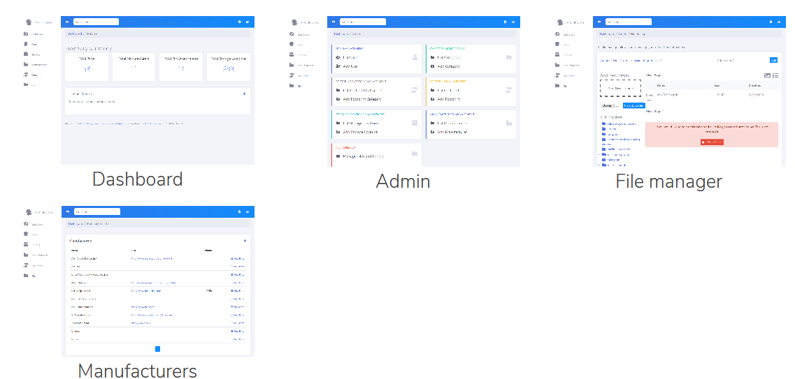

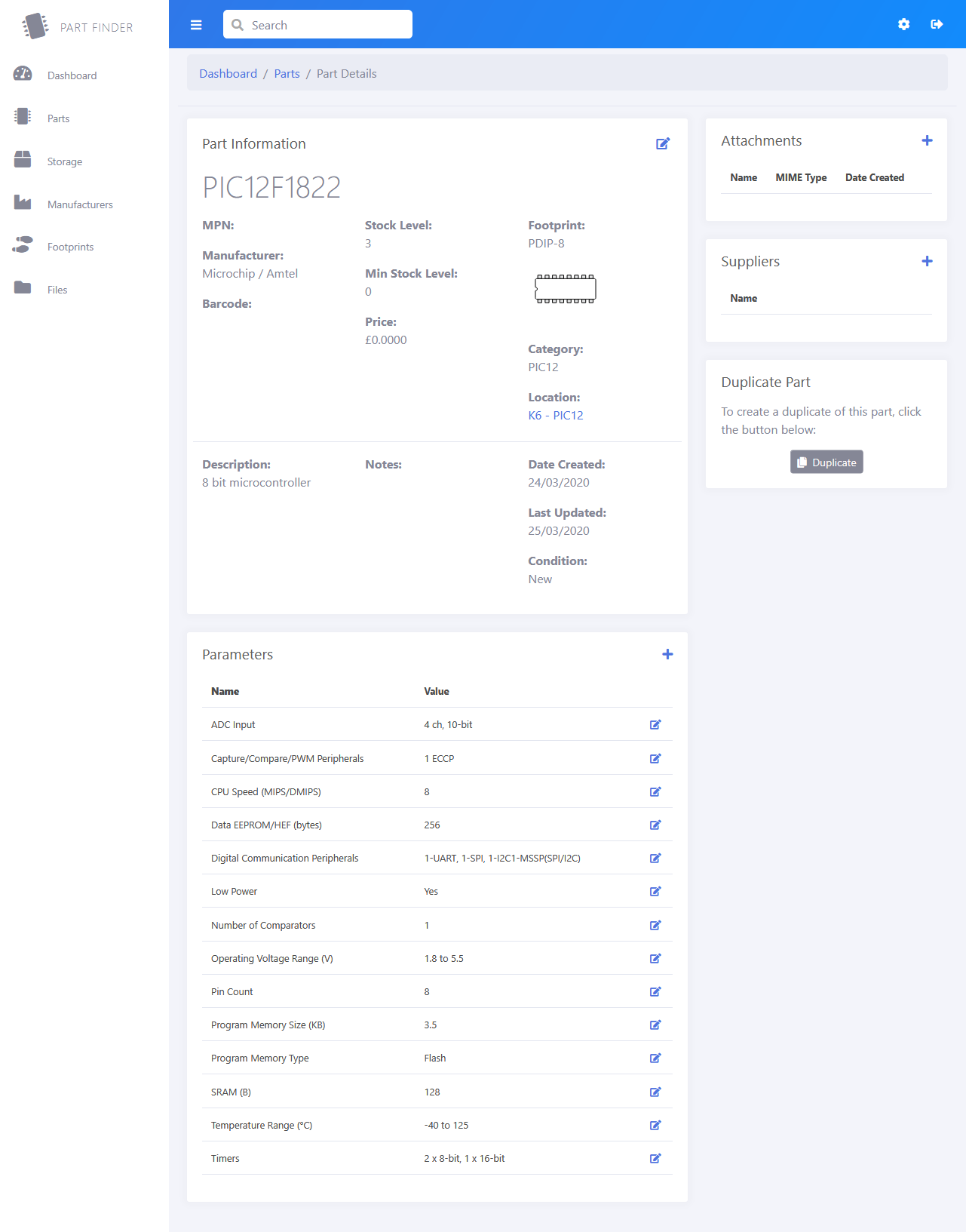

The admin section contains a file manager that allows you to create directories/folders and add files within the “/docs” folder in the website root. This will need to add read/write permissions for the IIS/User account on your server/computer for this folder. The Dashboard gives you an overview of the system with totals for Parts, Manufacturers, Attachments, and Storage Locations. It also lists any parts which have less than your low stock level available. The Parts section is where you manage all your components/parts with a tree-view or list view to find your parts and a parts details page with your item’s main details, attachments, suppliers, and parameters. You can also duplicate a part if you are adding similar new items.
In the Storage section, you can add and edit your storage locations before adding new parts for each location. You can add storage locations one at a time or use the Storage Location Grid page to bulk add locations such as storage drawers etc. These can be edited in the admin section (cog icon). In the Manufacturers section, you can add and edit component manufacturers before adding new parts. These can be edited in the admin section (cog icon). In the Footprints section, you can add and edit your component footprints before adding new parts. These can be edited in the admin section (cog icon). The file manager allows you to view the /docs folder on your PartFinder website. You can add upload new files and create folders, view, and delete files.
Please note if you delete a folder or file which is linked to an existing part, it will not remove the database record for the file. The admin section has Add, Edit, and List pages for Users, Categories, Footprint Categories, Footprints, Storage Locations, Manufacturers, and the file manager.
