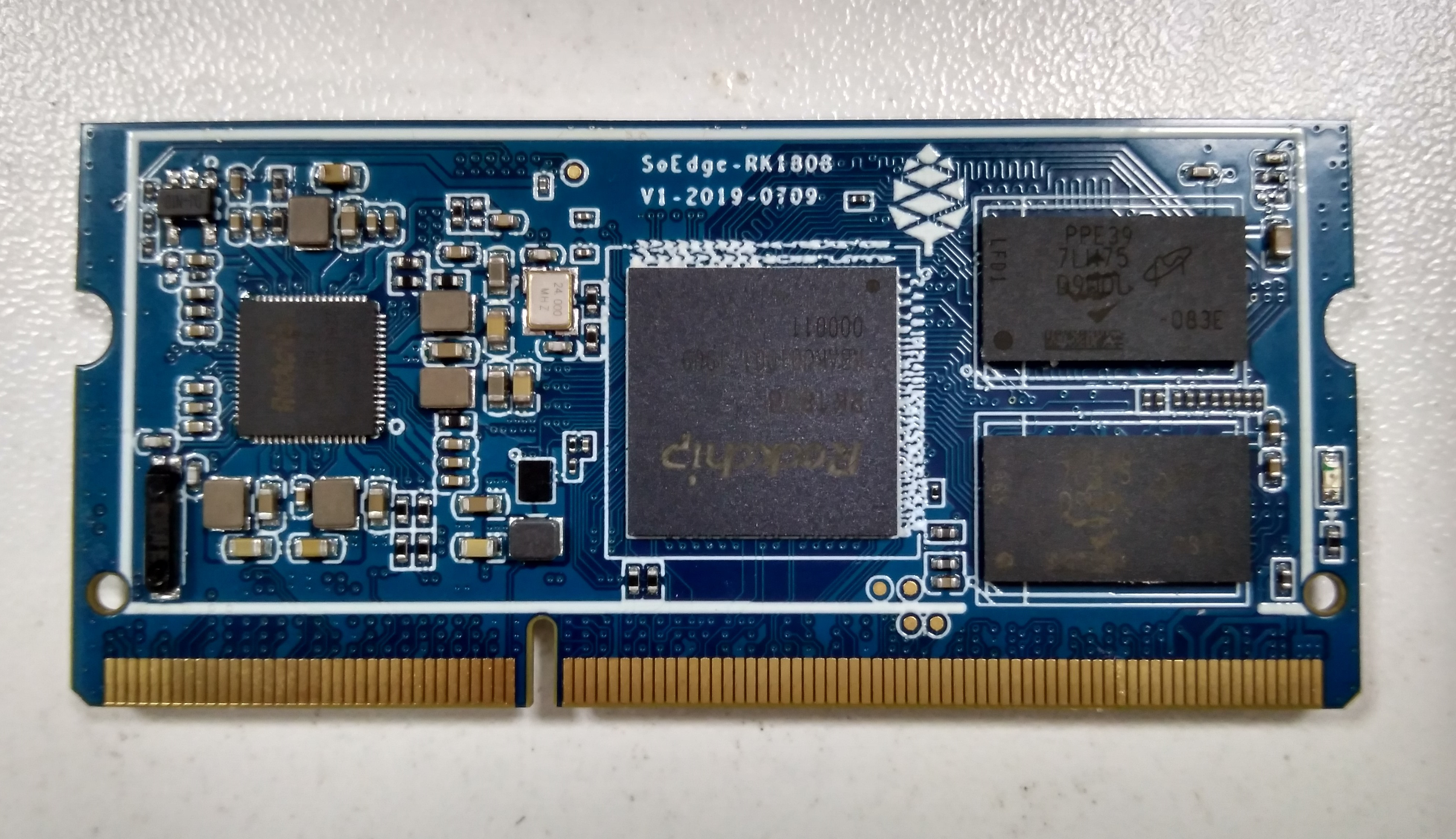

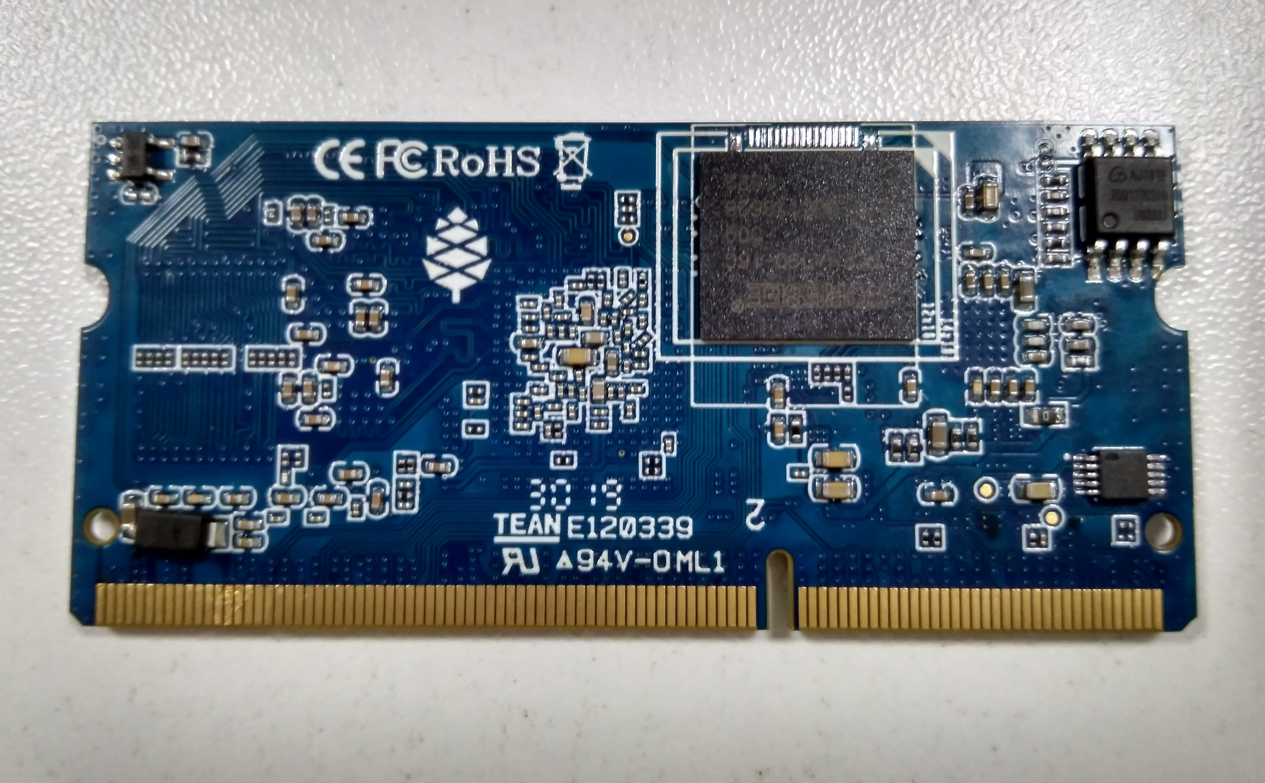

SoEdge-RK1808 SoM Specifications
  • SoC – Rockchip RK1808 dual-core Cortex-A35 processor with 3.0 TOPS NPU (Neural Processing Unit)
  • System Memory – 2GB RAM (2x 8GBit Micro DDR4-2400) but limited PC-2133
  • Storage – 16GB eMMC 5.1 flash (FORESEE NCEMAD9D-16G)
  • PMIC – Rockchip RK809-2
  • Edge Connector – 204-pin SO-DIMM connector
  • Dimensions – 67.9 x 31.0 mm (following DDR3 SO-DIMM / SoPine64 form factor)
There’s no information about software right now, but SoEdge-RK1808 should run Linux, and support RKNN-Toolkit for AI acceleration just like RK1808 AI (USB) Compute Stick.

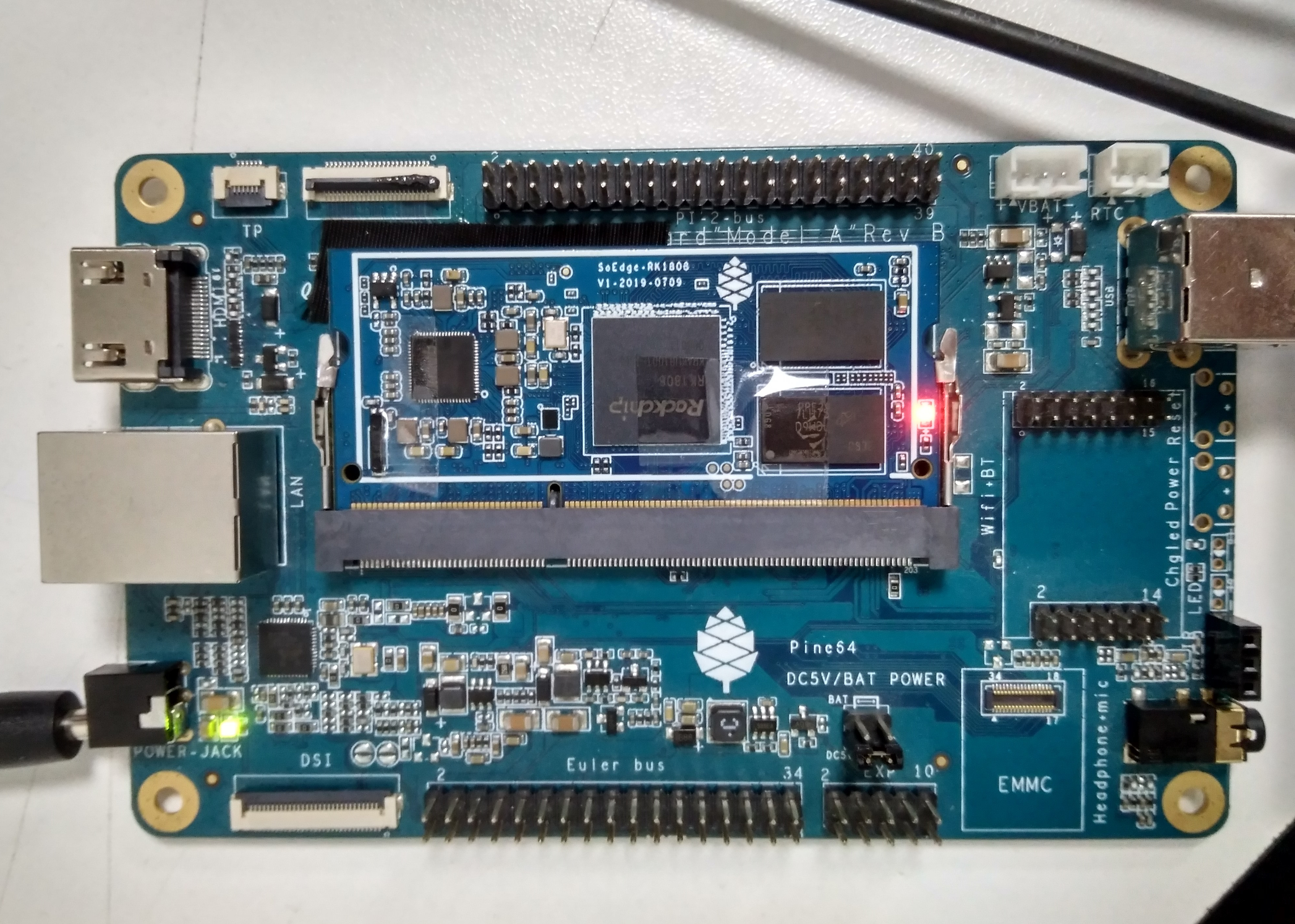

SoEdge-R1808 and SOPINE Model A Baseboard
As mentioned previously SoEdge-RK1808 appears to be compatible with SOPINE A64 SoM and fits into SOPINE Model “A” baseboard.
It should be noted that all ports may not be working on that baseboard, since for example RK1808 does not support HDMI, but MPI DSI and CSI connector should be fine.
SOEdge-RK1808 module price will be the same as SOPine A64 module, or $29
