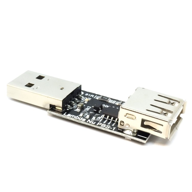

PowerEver is a tiny electronic board that will keep your commercial power bank running non-stop while minimizing self-drained current. It is user adjustable and is compatible with nearly all power banks in the market.
PowerEver is a tiny electronic board that will keep your commercial power bank running non-stop while minimizing self-drained current. It is user adjustable and is compatible with nearly all power banks in the market. This means that your power bank will never run short of mobile power for your electronic gadget.
This board is perfect for electronic enthusiasts, field engineers, and students as well as anyone needing a mobile power supply using commonly available power banks. Help save the environment by maximizing power bank usage, especially for older models that cannot provide enough power to mobile phones but are still usable with less current-hungry electronic devices. For example an Arduino, ESP8266 and more.
  • Use generic mobile phone power banks as a regular DC 5V power supply for powering all kind of gadgets and electronic boards
  • User adjustable through button triggering to suit almost all power banks
  • Designed to consume a self-drained current as low as possible
  • Small and light-weight enough to put into your wallet
  • Fully open source with complete schematic and source code provided for immediate tweaking
Specifications
Micro Controller
  • ATTiny13A running 1.2 MHz at 5V
Power
  • 5VDC powered by any mobile power bank
  • Adjustable total current drain from 110 mA down to 3 mA (16.5 mA as default)
Buttons and Connectors
  • 1x USB-A male for connecting to a power bank
  • 1x USB-A female output to user loads
  • 1x push button
Status Display
  • 1x blue LED for visual feedback
Dimension and Weight
  • 16 mm x 50 mm
  • 5.9 g
Optional Accessories
  • USB-A male to 5 pins screw terminal connector
