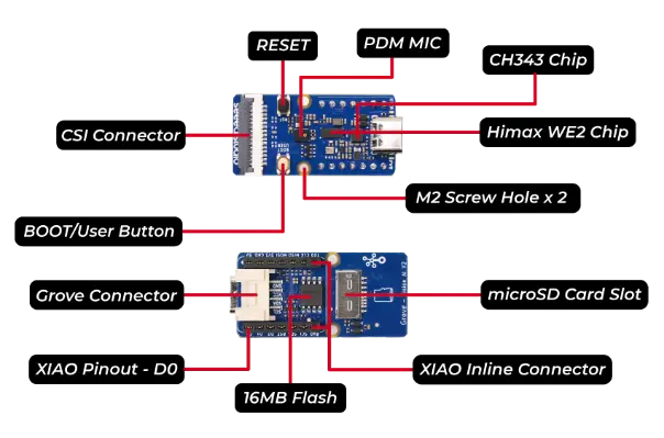

Grove Vision AI V2 specifications:
  • Microcontroller: Equipped with the Himax WiseEye2 HX6538 processor, featuring a dual-core Arm Cortex-M55 and an integrated Arm Ethos-U55 microNPU.
  • Processor Frequencies:
    • Arm Cortex-M55 (Big) – Up to 400MHz
    • Arm Cortex-M55 (Little) – Up to 150MHz
    • Arm Ethos-U55 MicroNPU – Up to 400MHz
  • Onboard Peripherals: Includes a PDM Microphone and an SD Card Slot.
  • Interface Options:
    • Camera Interface: Standard CSI for OV5647 camera module.
    • Other Interfaces: IIC, UART, SPI, and USB Type-C.
  • Power Supply Options: Supported through a dual 7-pin connector, USB Type-C, and a Grove Connector.
  • Input Voltage: 5V power input.
  • Internal System Memory:
    • Configurable system memory, up to 2432KB
    • 64KB boot ROM
  • Storage Options:
    • Memory Card Interface supporting up to 1x SD and SDIO host in DS mode at up to 25MHz.
    • Additional 16MB flash storage for firmware.
  • Default UART Speed: Communication rate set at 115200.
  • I2C Interface Compatibility: Compatible with Seeed Studio XIAO and Arduino platforms.
  • Firmware Burning Interface: Via USB Type-C.
