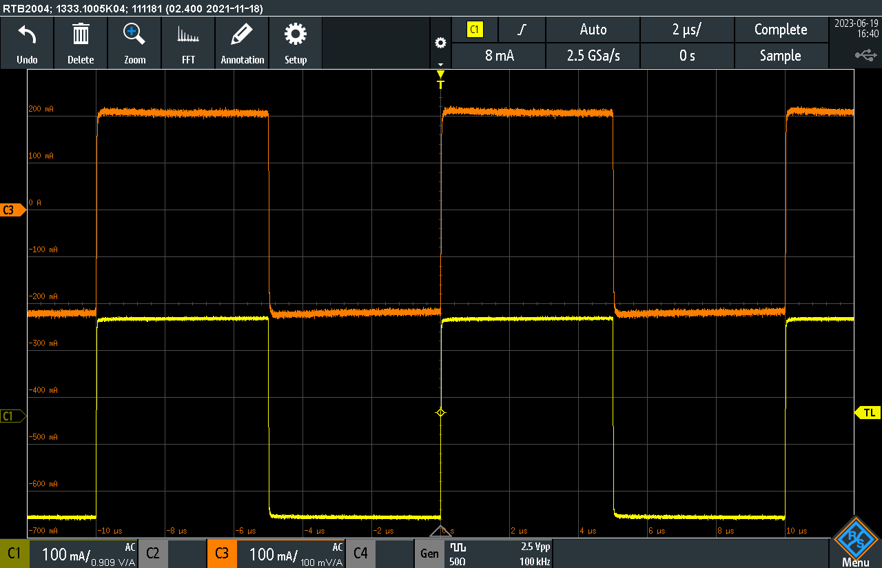

The Rogowski-Relief current probe, utilizing a Rogowski coil, has proven to be an invaluable tool for measuring high-frequency AC currents in confined spaces. Its design facilitates non-intrusive current measurements, making it highly versatile and applicable in various scenarios.
The Rogowski-Relief current probe, utilizing a Rogowski coil, has proven to be an invaluable tool for measuring high-frequency AC currents in confined spaces. Its design facilitates non-intrusive current measurements, making it highly versatile and applicable in various scenarios. The probe comprises two main components: the Rogowski coil and the integrator/amplifier, working in tandem to deliver accurate and reliable current readings.
One of the significant advantages of the Rogowski coil lies in its ability to measure high-frequency AC currents without disrupting the circuit under test. The sensing coil’s optimized size allows it to fit between the leads of a TO-220 transistor or slip around the leads of through-hole power components, making it suitable for tight spaces.

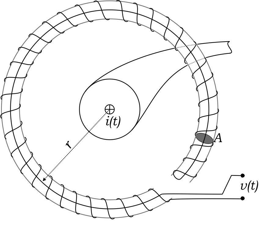

The underlying principle behind the Rogowski coil’s operation is based on Ampere’s law, wherein the coil generates a voltage proportional to the change in the magnetic field induced by the current-carrying conductor encircled by the coil. This unique characteristic allows the Rogowski coil to produce a voltage signal corresponding to the rate of change of current (dI/dt), making it ill-suited for measuring DC currents.

While the Rogowski-Relief current probe has proven effective for general-purpose lab use, the most recent version of the integrator encountered issues with interference from wireless signals like WiFi and LTE. To address this problem, design updates have been made to the PCB layout, allowing the circuitry to be shielded by a metal can, thereby minimizing the impact of external signals on the probe’s performance. However, these updates remain untested at the time of this summary.
