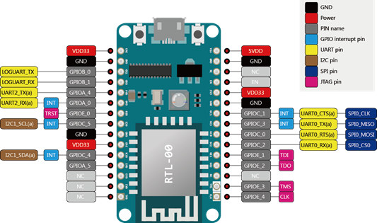

The B&T BW16 module is based on the Realtek RTL8720DN wireless MCU and sells for $3.90 minus shipping fees. If you like how cheap it is and you are interested in it but do not feel like soldering wires or creating your own baseboard, then you will be glad to further meet the new dual-band IoT board called Rtlduino RTL8720DN.
The Rtlduino RTL8720DN in a compact form factor is fitted with a B&T BW16 module and offers an easy way to evaluate the RTL8720DN dual-band WiFi and Bluetooth LE 5.0 microcontroller. The Rtlduino RTL8720DN board is also affordable and sells for only $6 plus shipping.
Here are some of the key features and specifications that the Rtlduino RTL8720DN board has:
  • B&T BW16 wireless module with:
    • Realtek RTL8720DN MCU with KM4 Arm Cortex-M4 core @ 200 MHz and KM0 Arm Cortex-M0 core @ 20 MHz
    • WiFi 2.4G and WiFi 5G with protocol 802.11 a/b/g/n 1×1 from 20/40 MHz up to MCS7
    • WiFi low power mode support
    • Bluetooth 5.0 LE support with a frequency range of 2.402GHz – 2.480GHz; Receiver sensitivity of -92 dBm; Transmit Power of +7 dBm
    • IPEX connector or PCB Antenna
    • 16x castellated holes with GPIO, 2x UART, 1x I2C, 1x SPI, 4x PWM, 1x ADC, 3.3V, GND, and,
    • 3.3 ±5% supply voltage.
    • Temperature Range: From -20°C to 85°C (operating);  from -40°C to 125°C (storage)
    • Relative Humidity: 10% ~ 90%
    • Dimensions: 24 mm x 16 mm x 3 mm
    • Certifications: FCC, CE, RoHS, and, SRRC
  • 1x Micro USB port
  • 2x 15-pin headers with BW16 I/Os
  • Reset button
  • Burn button
  • RGB LED
  • 5V power supply via Micro USB port
  • Dimensions: 49 mm x 26 mm
