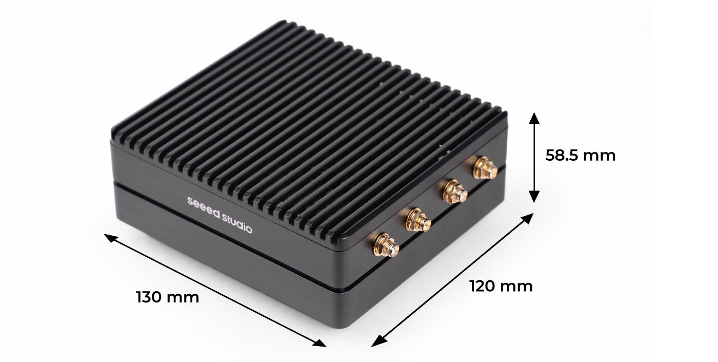

Seeed Studio’s reComputer J3011B Edge AI PC is powered by the NVIDIA Jetson Orin Nano module, featuring a 6-core Arm Cortex-A78AE v8.2 64-bit CPU with up to 67 TOPS AI performance in super mode. It includes up to 8GB of 128-bit LPDDR5 memory and comes with a pre-installed 128GB NVMe SSD for storage.

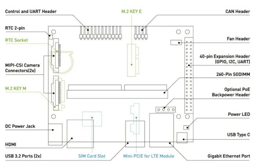

The system offers multiple connectivity options, including two USB 3.2 ports, three USB 2.0 ports, an HDMI 2.1 output, and a Gigabit Ethernet port. Expansion is supported through M.2 slots for Wi-Fi and Bluetooth modules, a mini PCIe socket for LTE, a 40-pin GPIO header, and a 12-pin UART header.
Encased in a compact aluminum chassis with active cooling, it operates within a -10 to 60°C temperature range and supports a DC 9-19V power input. Designed for AI, IoT, and edge computing applications, it is suitable for traffic monitoring, EV battery management, and waste management systems.

Seeed Studio reComputer J3011B Edge AI PC specifications:
  • SoM: NVIDIA Jetson Orin Nano 8GB
    • CPU: 6-core Arm Cortex-A78AE v8.2 64-bit @ 1.5 GHz (1.5MB L2 + 4MB L3)
    • GPU: 1024-core NVIDIA Ampere architecture with 32 Tensor Cores
    • AI Performance:
      • 40 TOPS (sparse)
      • 67 TOPS in super mode
    • Memory: 8GB LPDDR5, 128-bit with 102GB/s bandwidth (68 GB/s, up to 102 GB/s in MAXN_SUPER mode)
    • Video:
      • Video Encode: 1080p30 (1-2 CPU cores)
      • Video Decode:
        • 1x 4K60 (H.265)
        • 2x 4K30 (H.265)
        • 5x 1080p60 (H.265)
        • 11x 1080p30 (H.265)
  • Storage: Pre-installed 128GB NVMe SSD
  • Display: 1x HDMI 2.1
  • Camera Interfaces: 2x MIPI CSI (2-lane, 15-pin)
  • Networking:
    • 1x Gigabit Ethernet (RJ45)
    • Optional Wi-Fi and Bluetooth (via M.2 Key-E)
    • LTE support via mini PCIe (module not included)
  • USB:
    • 2x USB 3.2 Gen2 Type-A (10Gbps)
    • 3x USB 2.0 Type-C (device mode)
  • Expansion:
    • 1x M.2 Key M (for SSD)
    • 1x M.2 Key E (for Wi-Fi/Bluetooth)
    • 1x mini PCIe (for LTE)
    • 1x 40-pin GPIO header
    • 1x 12-pin control & UART header
    • 1x CAN bus
    • 1x 4-pin JST fan connector (5V PWM)
    • 260-pin SO-DIMM connector
    • 2x SPI, 2x I2S, 4x I2C, 1x DMIC, DSPK, PWM
  • Miscellaneous:
    • 12-pin button header
    • 1x RTC 2-pin, RTC socket (CR1220 support)
  • Power Supply: DC 9-19V via 5.5/2.5mm DC jack
  • Dimensions: 130 x 120 x 58.5 mm
  • Weight: 451.9 grams
  • Operating Temperature: -10°C to 60°C
  • Compliance: CE, FCC, KC, TELEC, UKCA, REACH, RoHS
Seeed Studio offers a 2-year warranty for the reComputer J3011B Edge AI PC and guarantees availability until at least 2032. Wi-Fi, cellular network modules, and RTC modules are not included and must be purchased separately.
