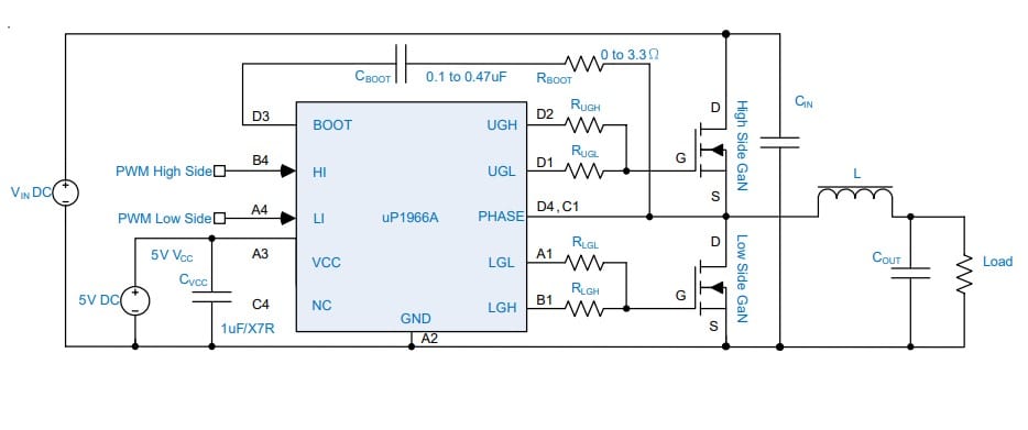

can I use uP1966 to drive high-side MOSFET only?
I think this is designed for both H and L-side MOSFETs and will not work for H only.
As mentioned in the data the high-side and low-side PWM signals can independently control. And while using only for high-side providing bootstraps capacitor to charge and discharge through phase pin, should this be working? in my case, I have a 48V input supply voltage and at the phase pin, I have a voltage swing of 24V to 48V to provide charge and discharge to the bootstrap capacitor instead of providing ground at the phase pin during bootstrap capacitor charge.
You should check the current source and sink capability of the PHASE pin in your case and the voltage tolerance of that pin. I think some tests have to be done to determine the chip’s behavior in this situation.
Does this gate driver need a bootstrap diode between a 5V (Vdd) power supply and a bootstrap capacitor?
quote from the datasheet:
So i think there is no need for external diode.
