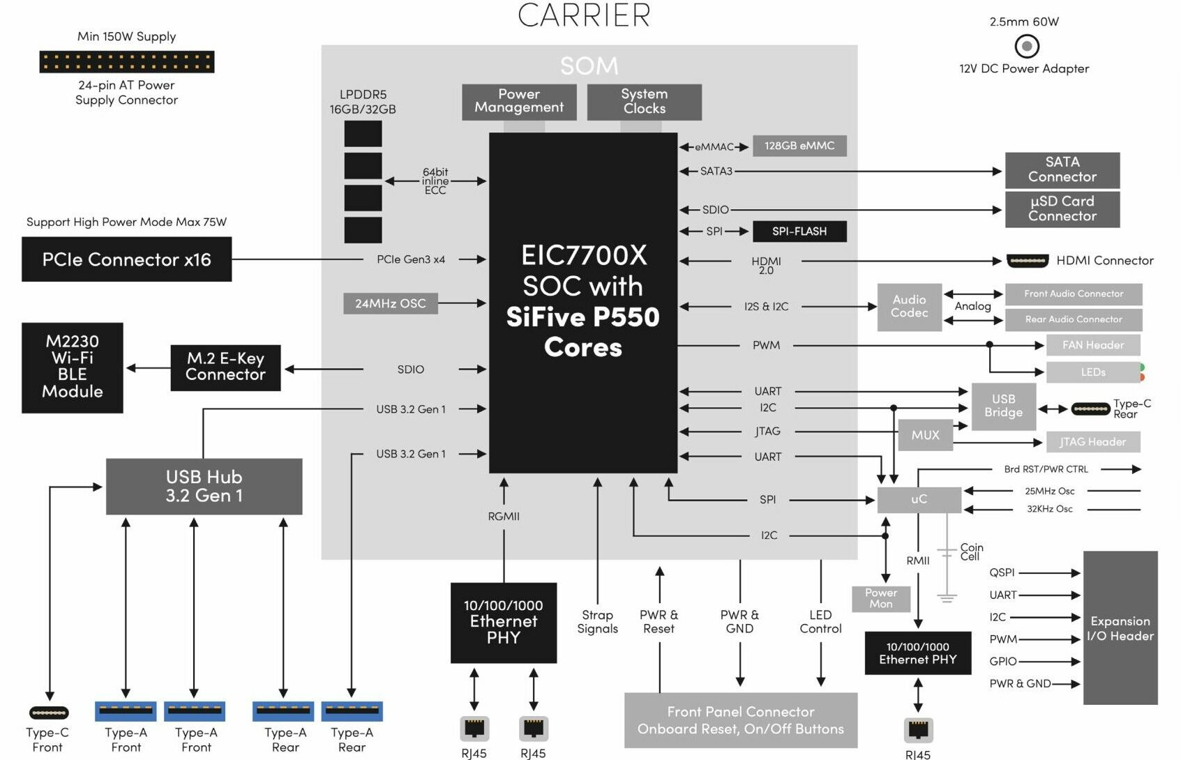

Specifications of HiFive Premier P550
  • CPU: ESWIN EIC7700X featuring a quad-core 64-bit SiFive P550 which is a triple-issue out-of-order 64-bit execution pipeline
  • Memory: Onboard 16GB/32GB 64-bit LPDDR5 at 6400MT/s
  • Storage: Onboard 16MB SPI NOR flash, onboard 128GB eMMC 5.1 flash, microSD card, and 2Kbit EEPROM
  • Networking: 1x 100 Mbps Ethernet and 2x 1000 Mbps Ethernet
  • External connections: 2x Gigabit Ethernet RJ45 connectors, 1x 10/100 Mbps RJ45 connector, 1x HDMI connector, 2x USB 3.2 Gen1 Type-A, 1x audio jack, 1x USB Type-C
  • Power supply: 24 Pin ATX power connector and optional DC 12V/5A adaptor, CR1220 3V Lithium Coin cell (not included)
  • Cooling: 1x pre-installed heatsink with fan and 2x 4-pin headers for chassis and system fan
  • Dimensions: 170.18×203.2×34.5 mm
  • Weight: 382.72 grams
