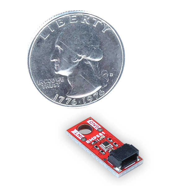

“Qwiic Micro is our smallest I2C-supported board form-factor yet!” says the company. “At only 0.75in. by 0.30in. (or 24.65mm by 7.62mm for metric friends), Qwiic Micro is perfect for projects and applications that have space or weight concerns.”

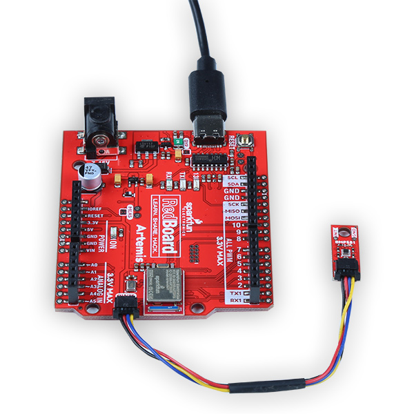

Qwiic Micro launches with four sensor boards: the first is with the BMP581 absolute Pressure Sensor from Bosch Sensortec, the second with the BMP384 pressure sensor from Bosch Sensortec also, the third with STMicroelectronics’ ISM330DHCX Six Degrees of Freedom IMU while the fourth with a triple-axis MMC5983MA magnetometer by MEMSIC. These breakouts are extremely small, you can install them in projects with exceptionally tight spaces. The Qwiic Micro Sensors communicate over I2C, so you don’t need any soldering to connect them to the rest of your project.
The Micro-sized SparkFun Qwiic BMP581 Absolute Pressure Sensor board – The BMP581 claims an exceptional resolution and accuracy of 1/64Pa. It uses on-chip linearization and temperature compensation to provide true absolute data for pressure and temperature. It also has a wide pressure sensing range of 30 to125 kPa as well as output data rates up to 622Hz. The minimum current consumption in all operating modes is just 1.5µA (typical) while the peak current consumption by the sensor is 260µA.
