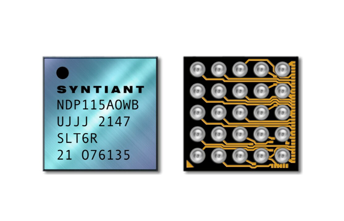

Syntiant Corp. unveiled NDP115 which is the newest addition to its neural decision processor family. NDP115 is a compact yet powerful processor with highly accurate real-time decision-making and sensor AI capabilities. The processor targets applications like self-driving cars, smart home devices, and wearable electronics. NDP115 is based on the company’s Syntiant Core 2 that can run multiple neural network loads at under 1mW power consumption.

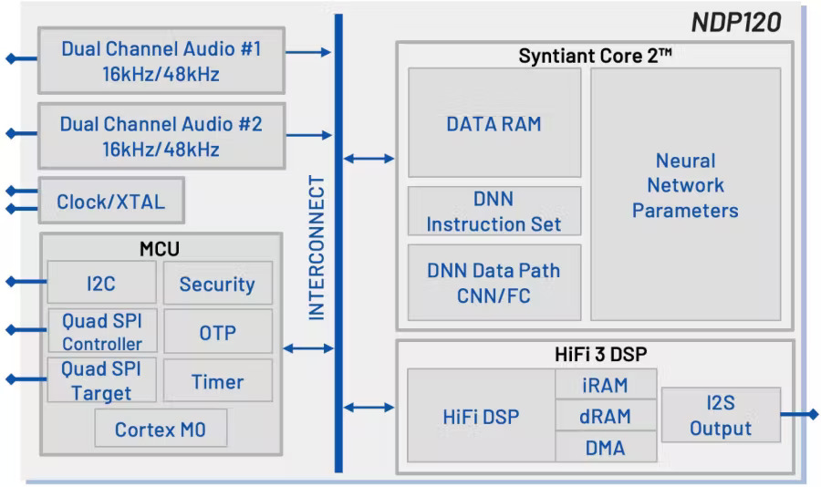

  • The Syntiant Core 2 enables multi-mode functionality in a tiny, cost and power- efficient form factor. It includes many processing elements, such as artificial neurons, that are used to process input data and make decisions.
  • In addition to the Core 2 neural processor, the NDP115 includes an embedded Arm Cortex-M0 microcontroller. ARM Cortex M0 is a 32-bit microcontroller and is based on the ARMv6-M architecture.
  • The NDP115 includes an embedded user-programmable HiFi-3 DSP with 144KB 64-bit data RAM and 64KB instruction RAM. This processor can handle up to 13 GPIO pins.
  • The NDP115 also includes support for I2C and PDM interfaces, which can be utilized for various purposes such as sensor fusion, multi-axis acceleration measurement, tilt detection, magnetic field sensing, and pressure sensing.

The NDP115 is based on the same architecture as the NDP120. The below diagram is a representation of NDP120’s architecture.
