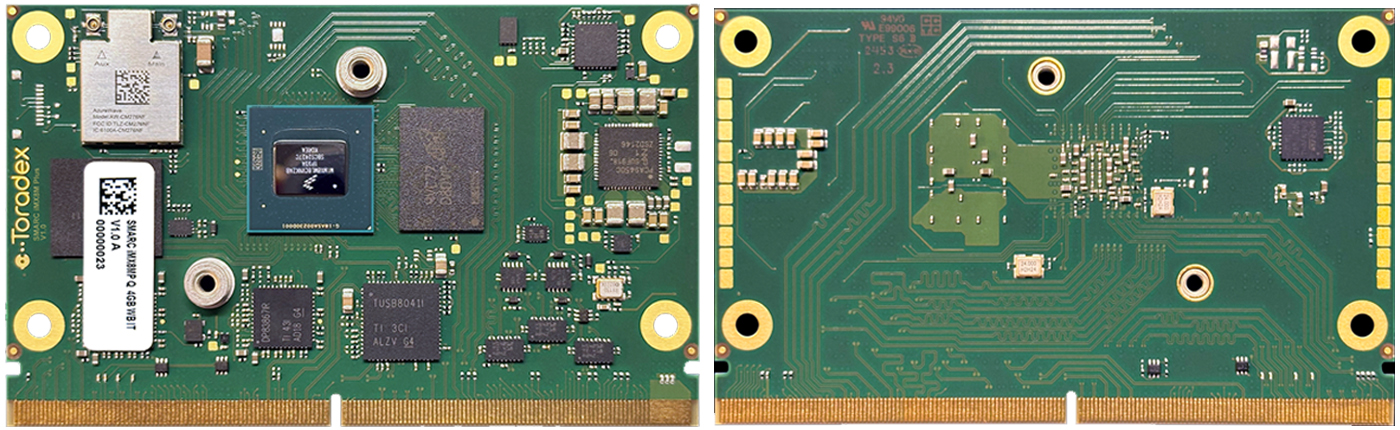

SMARC iMX8M Plus Module
Toradex offers industry-leading Linux support with long-term maintenance, an integrated secure remote update system (Torizon), and compliance with the EU Cyber Resilience Act (CRA). These modules are fully SMARC 2.2-compliant, ensuring compatibility with most SMARC 2.1/2.0 carrier boards. Toradex simplifies software migration, including transitioning from Windows to Linux, and offers hardware compatibility checks for seamless integration.

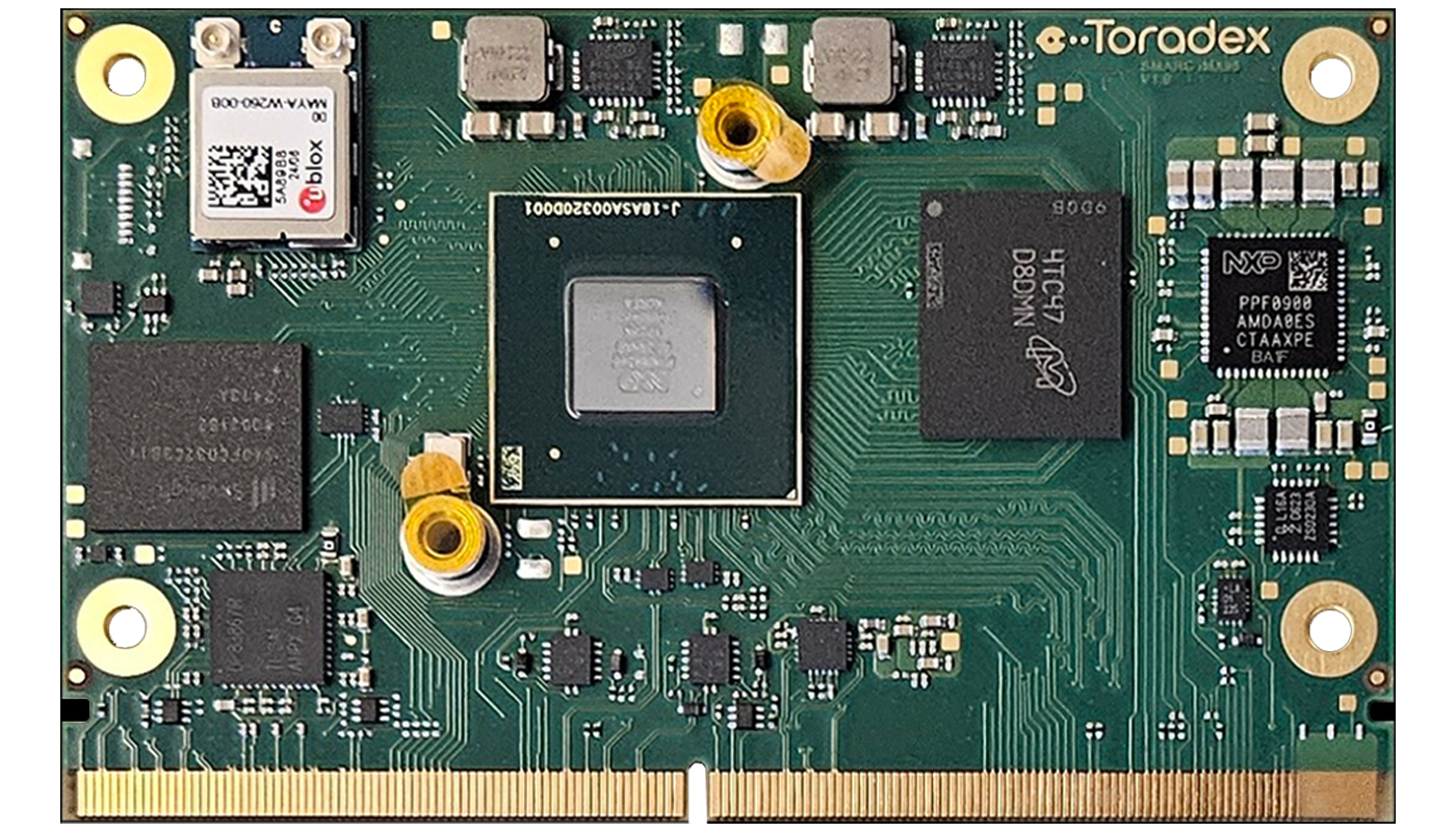

SMARC iMX95 Module
The iMX8M Plus and iMX95 modules feature ARM Cortex processors, Neural Processing Units (NPUs) for AI tasks, high-speed connectivity options like USB 3.2, PCIe, and Gigabit Ethernet, and multimedia capabilities with 4K HDMI, MIPI DSI, and CSI-2 interfaces. These modules are built to scale, have less power used, and have secure remote updates supported, long-term support is also received by them, making them a good fit for embedded systems that need to be reliable, safe, and flexible for industrial and commercial use.

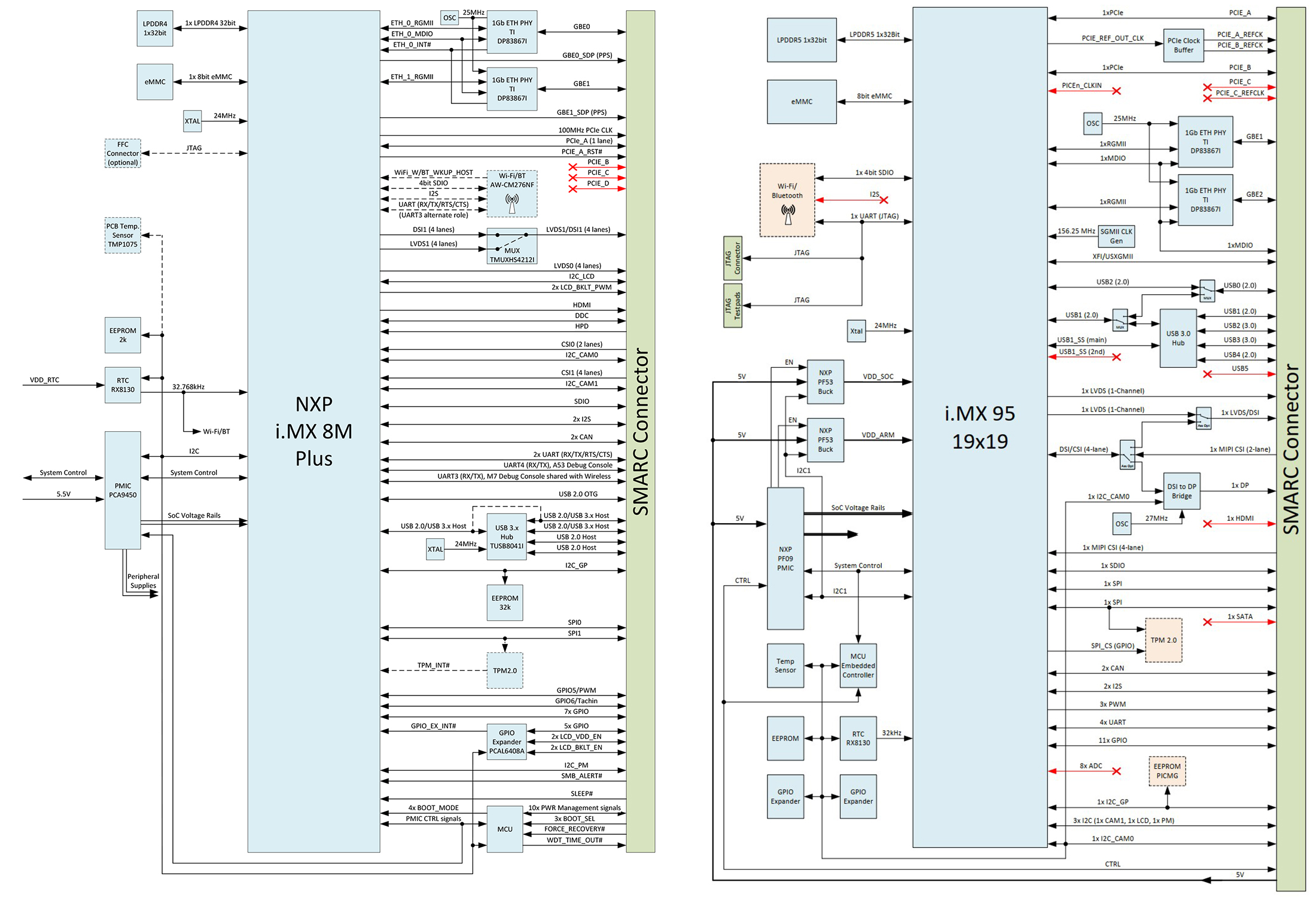

iMX8M Plus and iMX95 Block Diagram
Toradex SMARC modules support multiple operating systems, including Torizon, Yocto-based Embedded Linux, Toradex Easy Installer, FreeRTOS, QNX, Zephyr, and Android. Engineers design these modules for embedded computing in industries like industrial automation, medical devices, transportation, robotics, and IoT. They offer a secure boot, encryption, secure OTA updates, and compliance with the EU Cyber Resilience Act (CRA). With a focus on scalability, low power consumption, and long-term support, a reliable and flexible solution for industrial and commercial applications is provided by them.

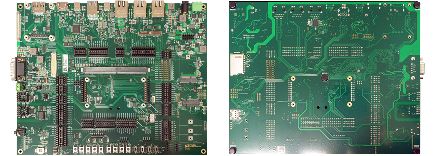

The Toradex company also mentioned its SMARC Development Board with HDMI Adapter, a fully featured carrier board designed for developers, providing easy access to all interfaces of the SMARC module family, including both Toradex and third-party ARM-based SMARC modules.
It supports industry-standard interfaces such as USB 3.0, USB 2.0, Ethernet (3x Gigabit), PCIe, I2C, SPI, UART, PWM, GPIO, RS232, RS485, SDIO, CAN, and JTAG. Multimedia connectivity includes MIPI DSI, LVDS (via an optional adapter), HDMI (via an included adapter), DisplayPort, MIPI CSI for cameras, and multiple analogue and digital audio options. With its compact 250 x 200mm size and a 9-24V power input range, the board offers flexibility and scalability for various embedded applications.
